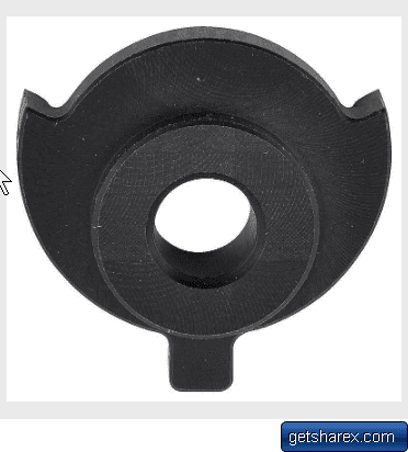

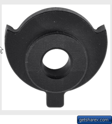

im trying to understand how the wiper motor linkage connects to the wiper crank/arm
when i took apart my wiper components in never included these (pictures attached)
i know i need the spring washers but the cam & release do i need both pieces?

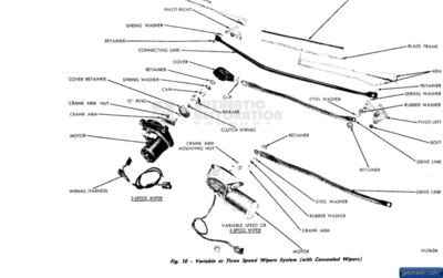

i attached a diagram from my 71 manual.

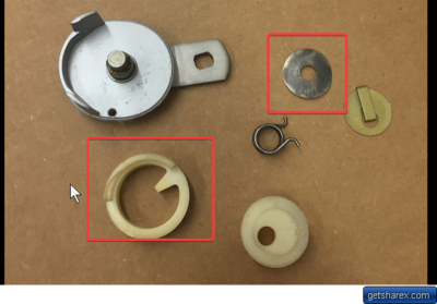

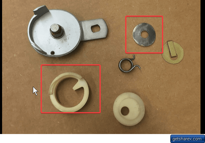

Do you have a 2-speed or 3-speed wiper motor?
If it's a 2-speed, you need all of those parts.
Yes, all parts on first pic are needed or will never park on the correct position. In fact wipers will play freely around when wiping the glass making a diff trace on every sweep.
Second pic is not part of the assembly for these

I need the release and the cam. The two plastic parts and curved disc washer.
Its a 2speed

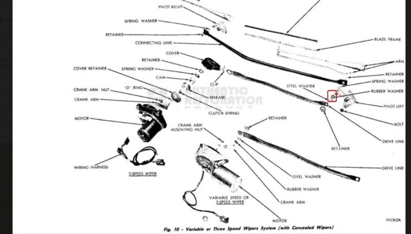

looks like there is a rubber washer thats needed
picture attached
what can i use for that? o rings?
that rubber washer could be just for cushion between linkages on earliers setups. Laters ( post 73 ) used a diff attaching method for linkages and that's not needed. I could say you can use a foamy sheet, same material used for light lenses gaskets or body gaskets and make it by yourself
