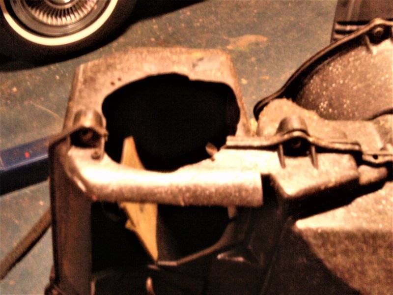

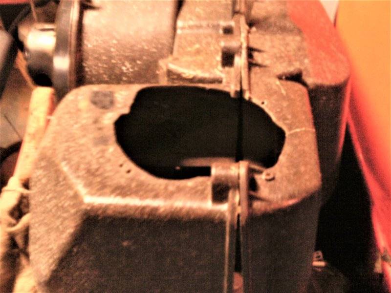

Hi everyone, I am doing some clean-up on my heater box and was wondering if a piece is missing,(Pass.side upper corner) see pic. It's a '71 GTX W/O AC and No Strato vent if that matters.

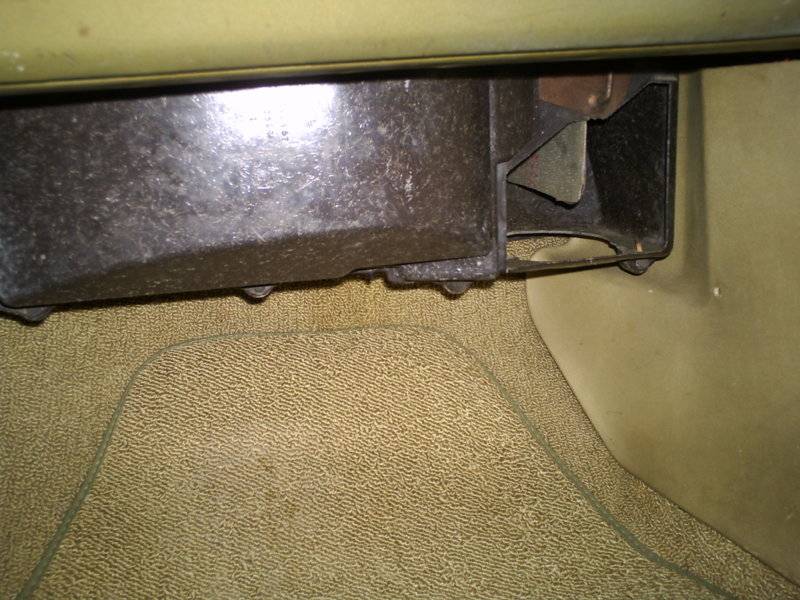

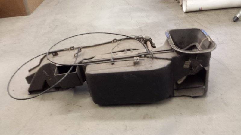

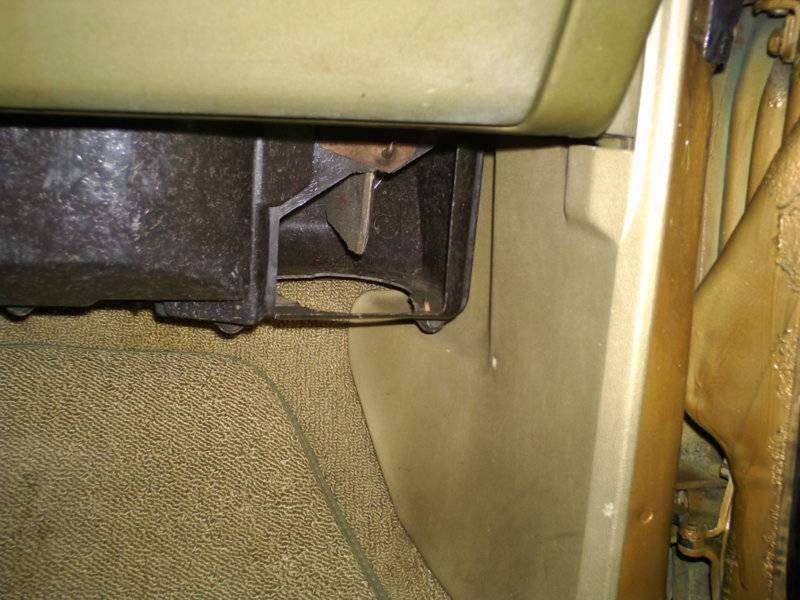

Should look more like this. That edge always seemed to get kicked and broken. Yours is pretty extreme. They reproduce that half of the housing.
I got the heater box out and I see the damage now on the bottom.So there is nothing missing from the front opening ? The vent door is exposed ? Anyone have a picture of a good installed heater box? Thanks
That hole looks like it was intentionally punched in there for some reason.
