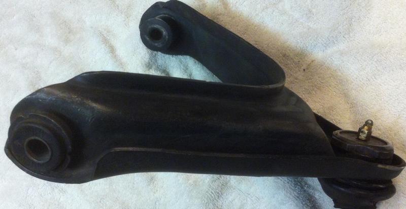

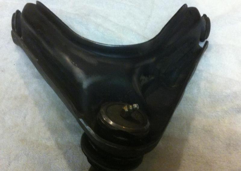

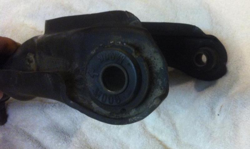

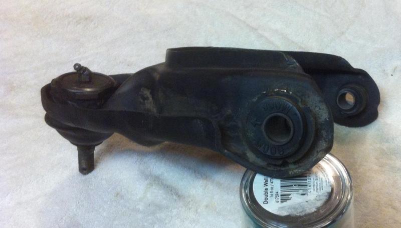

I'm having trouble seeing how my method is wrong. With the rear bushing: If the mounting hole is offset towards the outside of the car, it allows the end of the arm to move closer to the engine.
This is a Right side (Passenger) UCA that I was ready to use until the owner saw a defect near the ball joint sleeve. The bushings in this arm are in the same position as they are in the others that I did use.

Apologies Greg, looking at the last photo I realize they are installed correctly (I got confused :black_eye:)
In which case, I have no idea why your aligner could not achieve sufficient caster :icon_cry:
