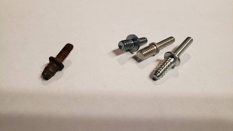

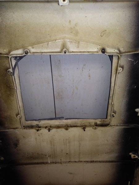

I yanked the air grabber bulge the other day to blast the hood and after getting everything disassembled, it looks as though it has all but 2 of the studs previously repaired. Was every mount between the bulge & hood a coarse stud into the bulge with a 1/4-20 thread for the nut on the underside? Were some just coarse or fine threaded bolts threading directly into the glass bulge & if so which ones?
Thanks.
yes
The machine thread is 10-24 on those studs.
Original and a few repos;
