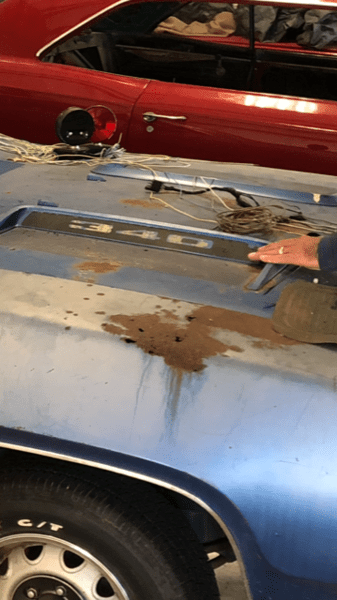

        Still inventorying things in my head before I pull the trigger, but the most immediate that come to mind would be a right front fender (seems like places like AMD don't make complete fenders for this model). The fender in question is rusted through at the top in a weird spot...like it had a battery or something sitting on top for a long time. Figured a full fender would be cheaper than paying a metal magician for fab the repair but it seems like 71 fenders are made of unobtainium.

        Show a picture. Sounds like it could be one that could be repaired if the rest is not rotted. As far as fenders some times you need to use a few bad fenders to make a good one..

        71-74 interior parts are somewhat plentiful except for some of the 71 only parts.
        Most of those can be replaced with 72-74 parts and they will work but not be technically correct.
        Body parts OTOH it seems parts collectors/vendors don't seem to stock very much.
        I just sold a decent PS fender- 1 quarter sized rust hole and 1 tiny ding.
        Is the rust on the flat top?

            Thanks. Here's the best shot I have. Rest of the fender is good, as is the inner.

            A good metal guy can splice that whole section in to where no one would know.... That section is not a common area for rot so even a fender that is rotted will probably have a good section like that there...

                That's a very repairable fender, if the rest of the part is good, I'd section good metal there.
