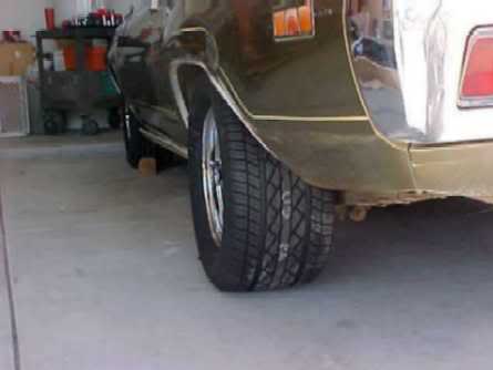

My 71 Road Runner has 15X7 or 15x8 Ralley wheels and 275x60 tires.I want to go with new Torque Thrust II wheels.What is the biggest tire wheel combo I can put on the rear without any rubbing issues? Is 295x15's possible?What size andbackspace do I need?
Thanks,Jim
this is from the roadrunnernest.com this is AZnicks 71' GTX
Re: Widest rear tire/wheel size?
Postby AZ-Nick on Tue Dec 08, 2009 1:36 pm
On my 71 GTX I have 295 x 50 x 15 on an 8" wheel with 4 1/2" BS and I think it fills the space just right.
I wish the tire was taller but you cant have it all....

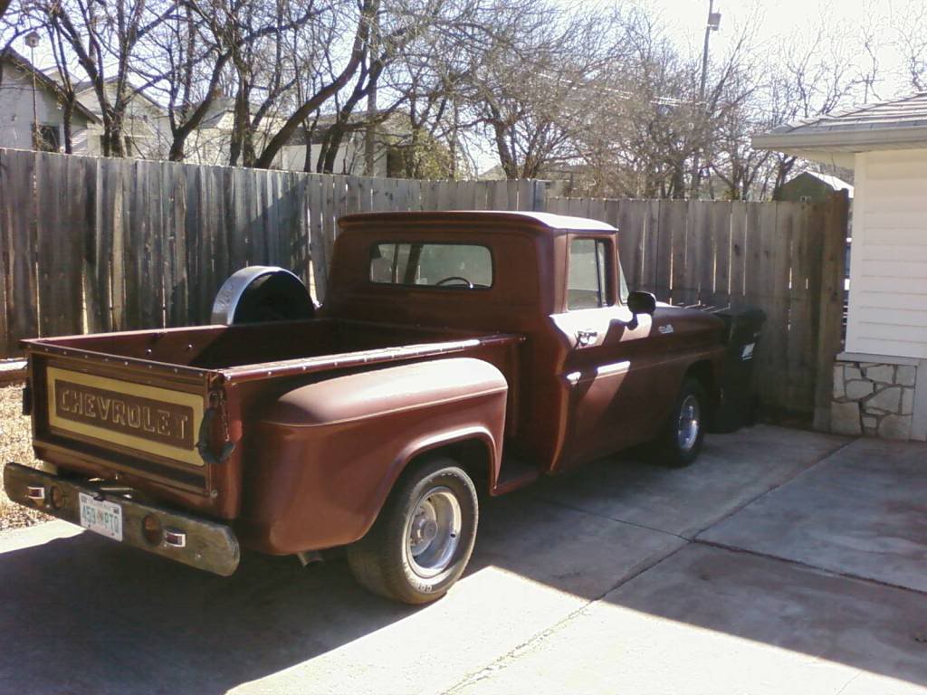

These are 295. 50. 15 on a set of 8" rally rims on my 62 Chevy.
If you want a bit taller, check out a set of 275.60.15. They look good on a set of 15x8 rims
