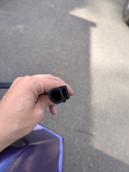

Hey everyone. I am working on the trim for my 71 RR and there is no stripping on the trunk. Can someone please post a pic of what this should look like on the car so I can make sure I orient the stripping correctly. I have attached a picture of what I am working with.
I'm sorry to say but I don't think you want to use that one. I bought mine from Classic Industries and it looked like that. Spent all the time to seal it and then my trunk would not close. I had to remove it all plus the sealer and discard. I bought one from Detroit Technologies and it worked perfectly on my 71 GTX.

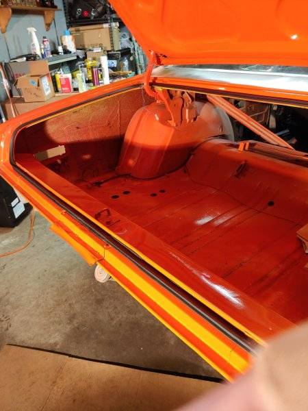

I agree with Z-Man, my 71RR trunk seal looks to be made solid of a sponge-type rubber and has a “Y” shape to it. See attached pics. My seal has a part number on it and may be a Chrysler original or replacement. Most likely the seal you are planning to use will result in trunk lid closing difficulty.

My seal looks like the pic above. When I installed it 8-10 years ago, I remember that it was very hard to close the trunk. After a couple months it worked well. Very easy to close after that now the seal still in very good shape.
