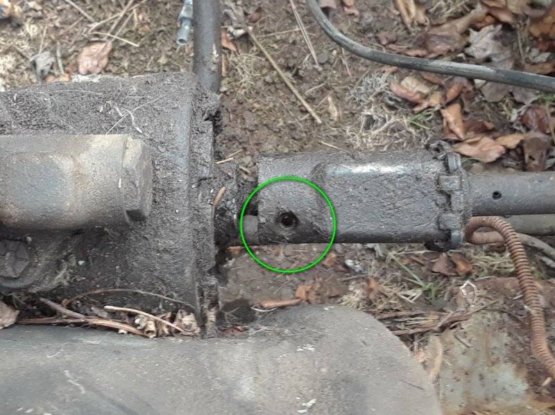

I have a 71 Satellite Custom I'm trying to pull the steering column from. I have everything ready to go except the shaft is still together with the steering box.
Never having messed with this on an old Mopar, I can't tell if the roll pin is still in there or not? It looks like there's a pin but I've done some moderate tapping without any movement.
Before I get aggressive with this thing, can someone verify? Just didn't know if the original was a solid pin & missing or if it's just a big hollow roll pin lodged in there real tight.
its a hollow pin shoved in there tight
beat it out with a pin punch

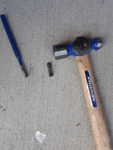

Well, it only took me 2 years to get the column loose from the steering box. Actually it took less than 10 minutes, had a LOT of family stuff come up that sidetracked me that I won't bore anyone with, as that's not what we're here for. I just wanted to say, in case it helps the next guy or gal, that what worked for me was a little heat from a propane torch & a 1/4" pin punch from the underside.
