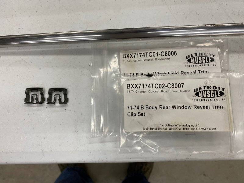

For a 71 B, is there a difference between the front and rear trim clips?

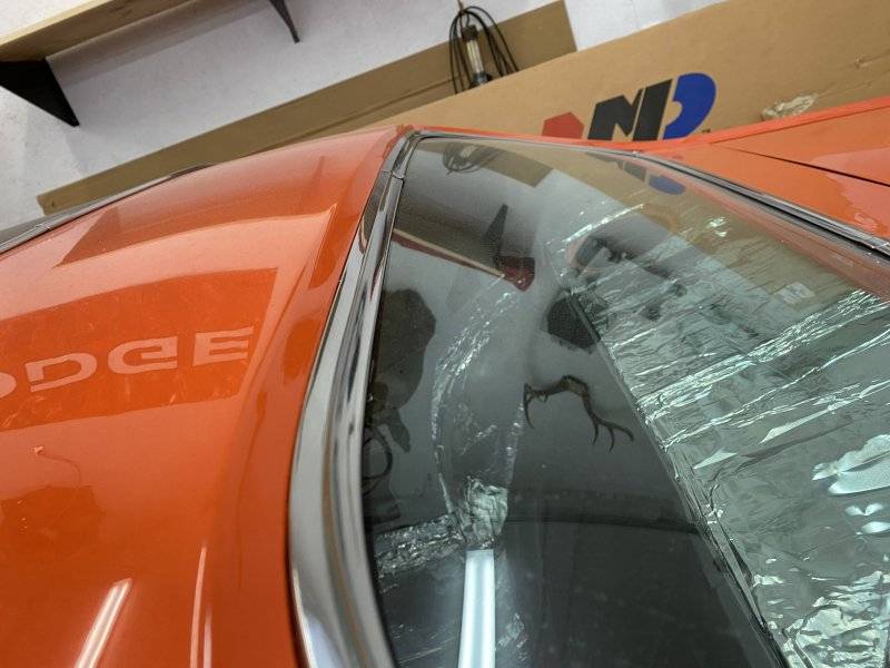

Reason asking is first, I have new front and rear glass. The glass was put in when deployed along with the trim clips.
Second: I tried to put the rear trim on but it won't go on. The rear glass looks like it's not centered properly. Too much gap from one side to another
Third- I also notice the rear doesn't have the little spacers in the bottom of the window channel, which I think it's not centered.
I'd like to know because IF the glass has to come back out, I'd like to have the right clips :BangHead:
Thanks!
The ones I bought for my 71 from DMT were two different part numbers for front and rear.
Thaks:BangHead:. If I have to pull the glass, I hope they're different or might just order new ones just in case

I think the rear will have to come back out. Something isn't right. Hoping to get someone over to look at it
After reading this thread, I sent Jim at DMT an e-mail and asked if there was a difference.
Here is his reply.
Here is his reply.
Thanks! I don't understand what Jim is saying "Woulda been to long a name to have one kit for frt OR back" but whatever. I'm glad to know that though. That eliminates that part then as to why the trim won't go on. That's telling me the glass is setting in the channel off center or wrong.:BangHead:

IDK. I have 2 sets of trim, one being the originals, and neither will snap completely in. It would partially, then on part of it, 2 of the clips kept coming off of the little rivet, started working on drivers side side trim. Pn the passenger side, it wouldn't go in
Sounds like the gasket is to thick. The trim should angle towards the glass when snapped in, if that makes sense.
I think the gasket is. Having someone coming over to look at it.
