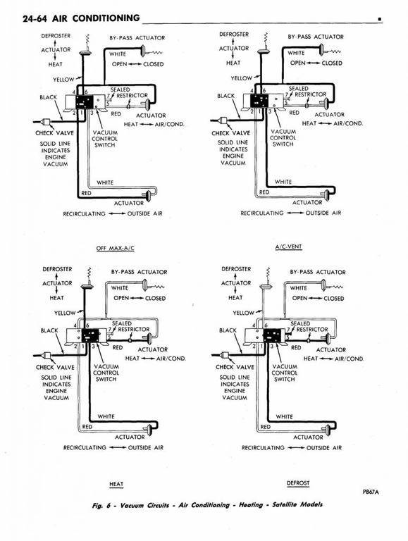

72 B Body Vacuum Line diagram
Mopar.Sherman
3:18 PM
Jan 11, 2012
5
0
USA
Hello All, i recently rebuilt my AC/Heater box for my 72 Dodge Charger Pro Street project. I'm using the original unit to Cool and Heat the car (its triple Black), since I've heard, the Vintage Air units may not have the CFM's to cool my car in the Southern California desert. Therefore, I'm in need of the DIAGRAM for the VACUUM hoses that connect the AC/Heater unit to the control switches on the dash ..? Can anyone out there help ..?
72RoadrunnerGTX your the best..! Thanks much for the quick response, and the accurate information .. ! I have much Love for you, please let me know if their is anything I can help you with in the future..
