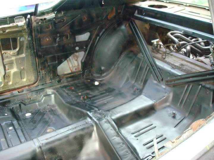

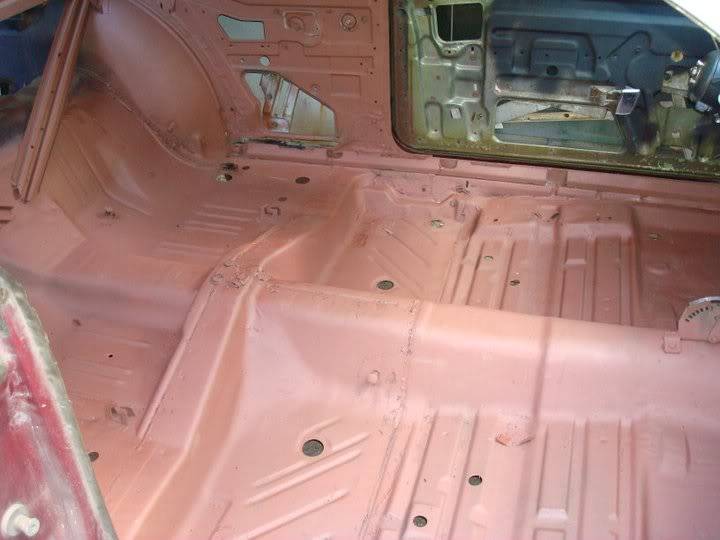

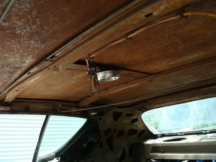

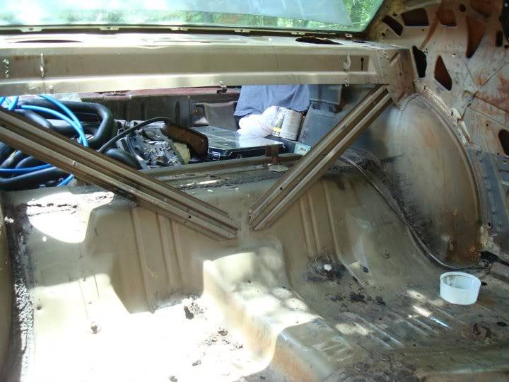

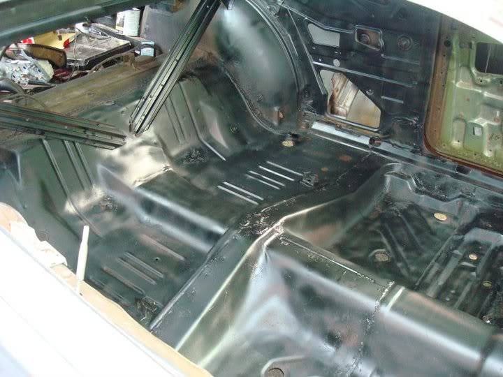

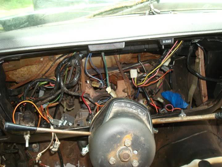

So after owning my 72 charger for almost 3 years, have finally been in the house long enough to settle down and work on the car. The pictures we took shows us working on the interior of the car. Trying to get the car fully ready to drive for our wedding on September 24th. Gonna be hard to do, but should be a fun challenge.

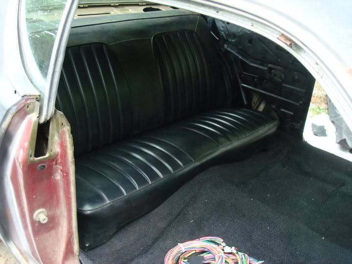

Carpet Replaced
Sound Insulator
Seats reupholstered and replaced

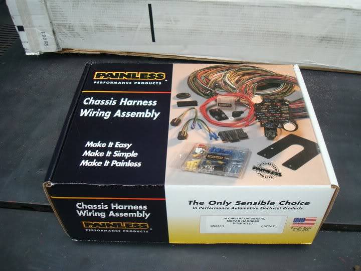

New wiring Harness

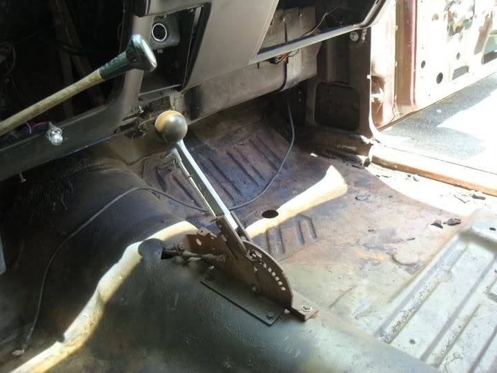

Transmission:
Still need to bite the bullit and order one of these. Prolly will end up going with the long planned 904 TCI streetfighter and breakaway convertor.

Wow, lookin good.

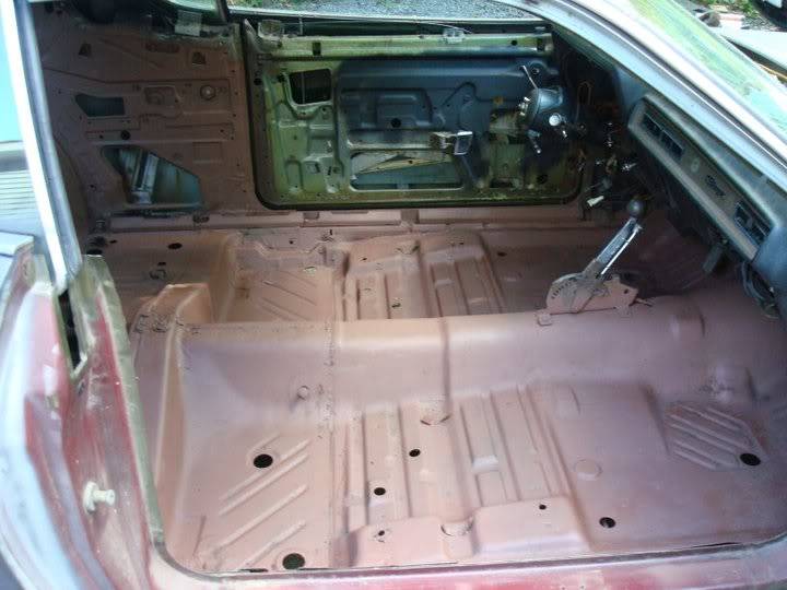

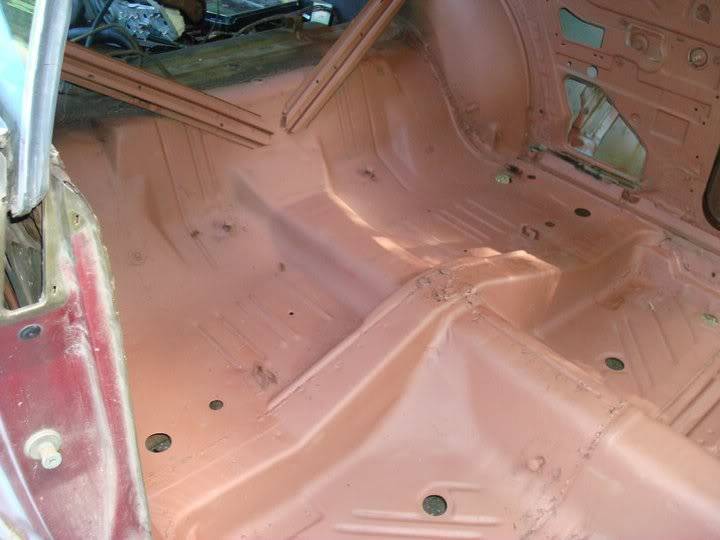

I am just about to start the interior of my car and I was wondering what you did to prep the floors and the product you used before putting in the sound dampening material.
Thanks,
Dennis
I just sanded down any surface rust on the floorboard. I used rustoleum paint from homedepot. There's a good article about using this kind of paint in Hot Rod during the last couple of months. Was fairly staight forward a decent price, I think around $20 for a quart of primer and paint.
