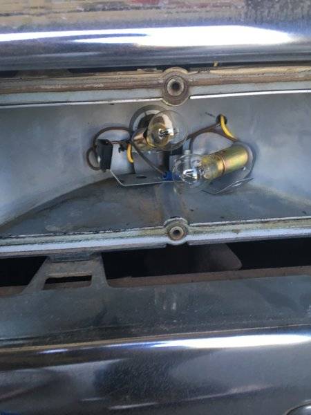

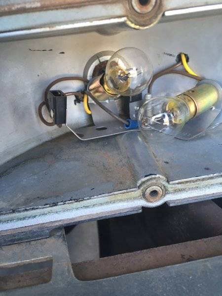

My 73 runner was the same way. I went to local store. Bought two trailer lights. Like 8.99 each or something. Pulled the guts out of them. Everything was mounted to a steel tab. Drill a 1/4 inch hole inside my tail light assy. Bolted the new piece in. Drill another 1/4 inch hole for wires. Ran all the wires in the back. Ground included. Wire up. All done. Brand new sockets in my old lamps. Under 20 bucks.
This is how I fixed the lights in my Roadrunner
My lights were single bulb but I added an extra. They could be mounted any direction that they fit. Just be sure to run a ground from the metal tab to the body ground inside the trunk.
