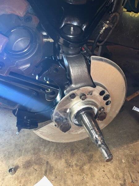

OK, I am proceeding on the front end rebuild and ran into yet another snag. Early on, I decided to replace the spindles with new ones, so ordered a pair from Dr. Diff. But when I go to finish the job by putting the rotor on, this spindle is too thick. About 1.36'" verses the old 1.24".

Note to self... You also need the 73 and up disk brake dust shields. The 72's and below have a large boss/lip on the outside facing the rotor. The new rotor won't go on all the way :( . Now I have ordered 73 and up dust shields ... argh. I SOOO want to get this done!
