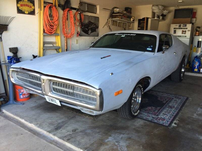

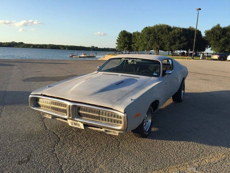

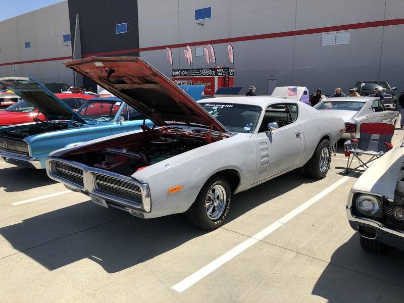

Hello fellow Mopar men. I. own a 1972 Dodge Charger Rallye 340 that I have had for 41 years. I am currently in the process of a complete restoration. I would like to reach out and get some installation tips on the N96 option I am adding to my car. Any input would be greatly appreciated. I have been following this forum for a while and just recently joined. Thanks in advance for having me.

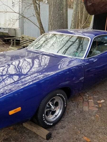

WELCOME @Loren White from southern NJ!! 41 years, NICE!! Advantage you have is ya know the car: Biggest thing I can pass along is repair RUST!! ALL RUST!! And cowl "overlap" areas which is a floor pans worst friend. Inside C-pillars behind sail panels get surface rust which bleeds to roof. Being a Texas car, hopefully you dont have these as my northeast car did: GOOD LUCK AND KEEP US POSTED!!

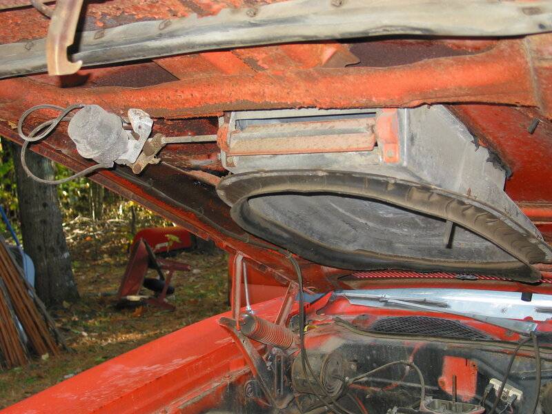

My concern is under the hood. On the forward side of the duct is where the lower door flapper attaches. Is the flapper supposed to open into the duct when the upper door is closed (in the closed position from the top) or does it sit flush against the duct. I have mine setup off the car and the upper door will not close completely. I may need to install the hood and connect the vacuum lines, but I have not finished assembling the car. Any suggestions?

Does the lower door flapper that is attached to the duct supposed to sit flush against the duct, or retract into the duct when the upper door is closed. I have mine setup off the vehicle and the upper door will not close properly. You can see the air grabber decal.
Welcome! Here is a pic of my old Super Bee of the duct with the door closed.
