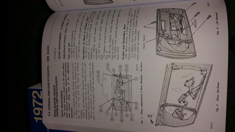

Wanting to find out if anybody has good instructions on removing and replacing all door window hardware like regulators and windows and channels ? I need to replace all the rollers and bought a kit but need literature so I have something to go from never messed with the windows before.
you will need the 72 body manual and take plenty of pictures of it installed before removal.
Where is a good place to get one of the body manuals?

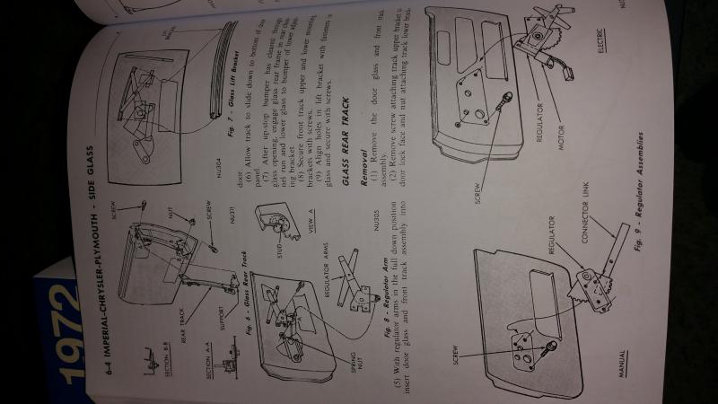

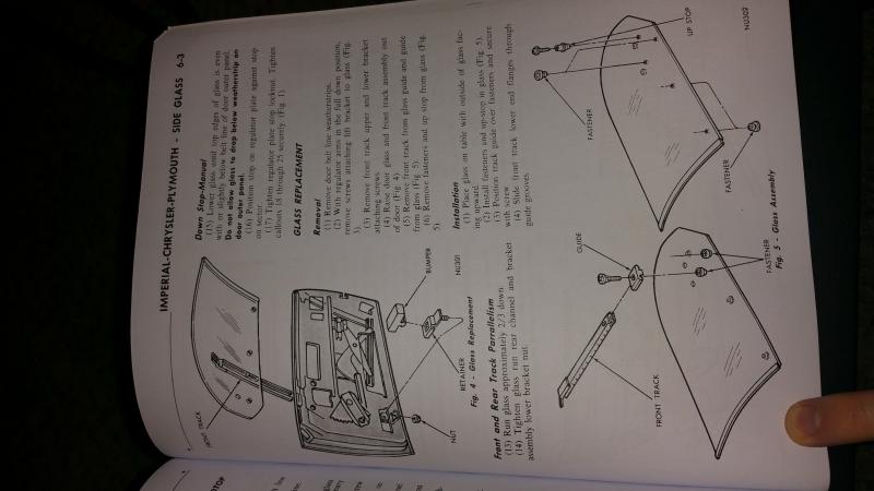

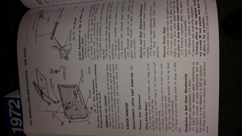

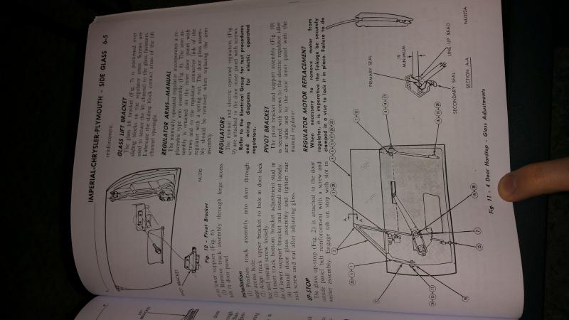

It's a little pricey but you can buy a Chrysler full service manual for a 72 on amazon for about 75 bucks. I'll see if I can take a few pics of the pages you need and post then below.
Hopefully this helps you out. I tried to get the best pic possible.
