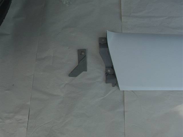

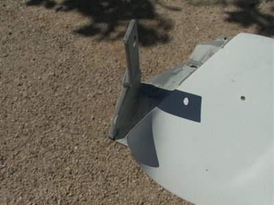

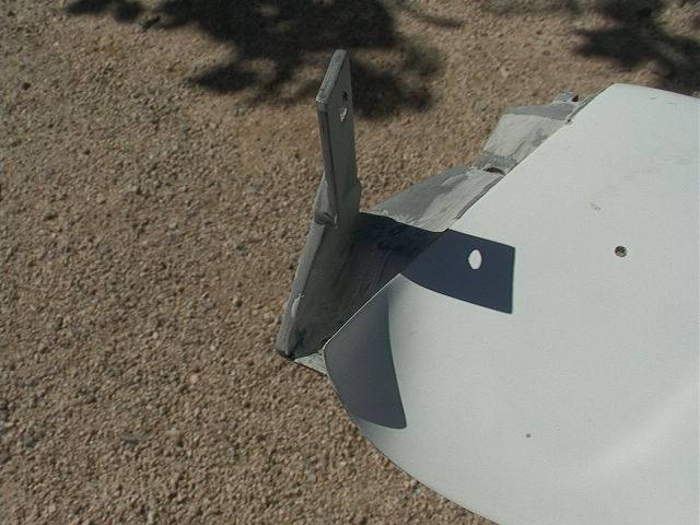

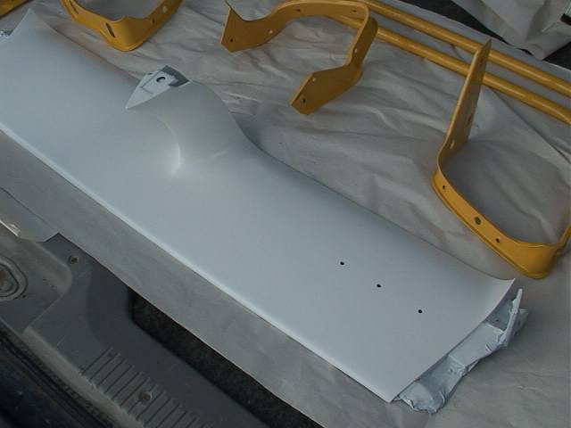

I used a generic that comes in very large containers at the paint store. The clerk just scooped some out of each part (one part is white, one part is black) and packaged it in two little tubs with lids for me. Then I mix the amount that I need at home. I use it to "restore" plastic parts that have pieces missing or have cracked (BBody center console, for example). Sometimes I reinforce using screws or metal ribbing so the part does not fail in the same place down the line.
Since I am doing the restorations in Mexico, unfortunately i can't tell you what name, company, brand, or label the stuff I used had.
Thank you, what type did you use?
The CRITICAL part about using epoxy is that it is the right kind of epoxy. Most epoxy doesn't stick to plastic at all, but there are some (mercaptan-based resin) that stick to plastic extremely well. The correct epoxy will stink like rotten eggs when you use it. You have to move really fast since the plastic epoxy turns solid in about 10 minutes.
