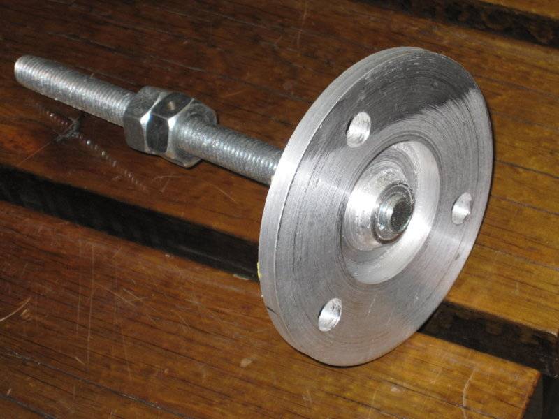

Yup, both correct above. The variation is in the casting of the case. A dial indicator on the crankshaft to the pump bore is the way to go.
I fabricated a mount for my indicator to bolt to the crankshaft flange. I took 4 readings at 90* intervals and purchased McRobb
adjustable dowels to correct the alignment. Mine was out .011". The case will need to be empty so you can work through the bottom opening.

A broken main cap & crank movement would sure explain it. I'd still indicate the case you plan to use. They can be far enough out to cause that problem.
