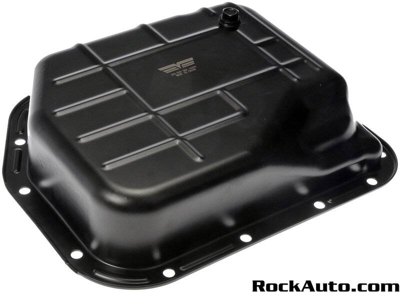

I hate red X's so I will respond. Nope! A deep pan is for extra fluid capacity and cooling. They were designed for racing of all types. In that case I would use a extension but in theory, for a street car, they really aren't needed. ANd like you said, you might as well save your money and use a shallow stock pan. THe newer 904 and 727 based overdrives have a deeper pan available. Just a stock steel one. If you're looking for extra fluid.
