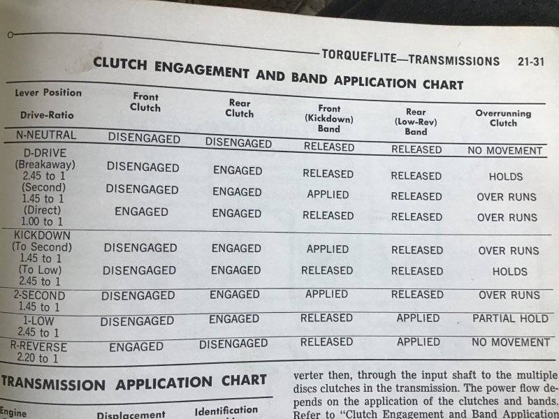

Starting in D engages the rear clutch. Starting in 1 engages the rear clutch AND the low/reverse band. Maybe you have a bit of slip in the rear clutch?
Yes the whole thing is magic!
Manual low engages the rear clutch and low reverse band. Partial hold on overrunning clutch.
In drive first gear uses the rear clutch and the overrunning clutch
The front clutch is only engaged in third gear and reverse.

"1" manual low applies the rear band and sprag, and also ignores the governor pressure so the trans won't shift to second until the selector is moved to second or drive.
"D" drive does not apply the rear band, and is harder on the sprag, but the transmission will try to automatically upshift when the governor pressure increases from the output / driveshaft speed

Yes, but some confusion because of the old reverse manual body instructions saying not to do burnouts in first, and use second gear, but that only applies to aftermarket manual valve bodies. starting in second gear in a normal forward body valve body is the same as in drive where you start in first with only the sprag to hold the drum. Use "1" manual low on a regular valve body to start a burn out so the low band is applied, and then shift into second gear.

Yes, if you do a high rpm burnout in manual low and back off the gas without shifting, you can take the sprag out and do some damage if not destroy the transmission.

Well not quite. The gear ratio is the same, rpm the same, slippage the same.. ( none) .. but the difference is the torque holding capabilities. If you easily drive off in drive, the sprag is capable of holding. The manual low and use of the rear band, is there for high torque capability. ( towing, launching hard etc)
