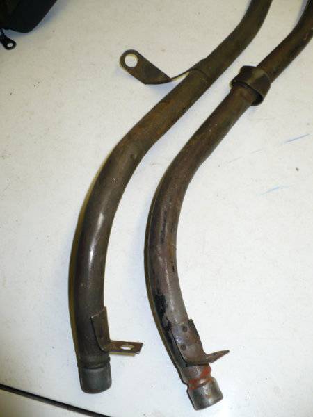

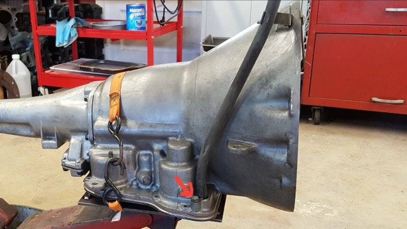

My 66 trans dipstick tube has a has a tab that bolts to trans.
On my '62 the tube has a tab at the bell housing plus a tab at the trans to unbolt. Maybe the one at the trans was eliminated on the newer models.
My 67 727 does not have the tube tab at the bottom.
Any rate, that how much of the later ones are, just the mounting tab at the engine/trans bolt. Depending on what year, like the ones pictured, takes an o-ring seal in the groove, later uses a slip in type rubber boot.
Beware! Have seen some get too rough trying to pull the o-ring type tube, and breaking it at the groove, from the o-ring getting hard and sticking.
Sorry for providing incomplete/wrong info. Never even considered that it might be an early model 727 trans.
