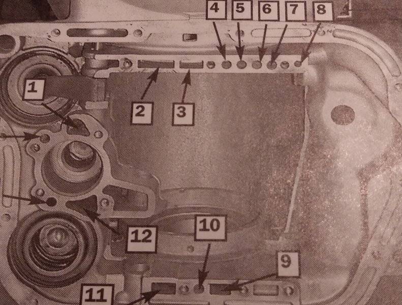

Check rear clutch. This can be air checked with the valve body removed using a rubber-tipped gun at about 30psi.
Port #5 is rear clutch apply.

If it has no forward gears there would be 2 prime suspects. #1 Rear clutch failure, piston seals or frictions worn. #2 Stripped front planetary splines where they ride on the output shaft. Both will result in reverse working with no forward gears. I've seen both of these failures. You won't find either of them with a pressure check. Both require disassembly of the transmission.
Doug
Thats a bad image.
