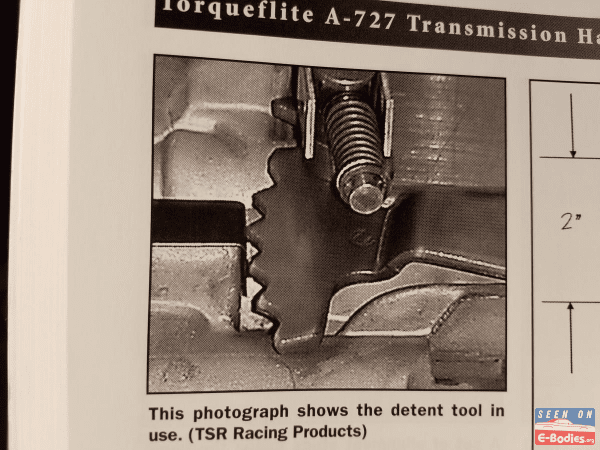

I'd start with an inspection of the "rooster comb" in the valve body. There is a spring loaded detent ball that is part of that which gives the feedback that you feel as you select a gear. Fortunately, the valve body is easy to remove.
Thanks! I think it's worth a shot to drop the pan and have a look, I would sure think it has to be something with the linkage internally or related to the valvebody somehow. I'm glad the pan on it has a drain plug! I'd definitely rather spend some time removing the valvebody than having to pull the trans again having just put it all together. There's a tech at Hughes that was great when I asked about low band apply and making sure what options it had so I'll chat with him tomorrow and follow up with what they recommend also since it should be under warranty.

The 727 book by Carl Munroe is excellent, as is the 904/727 book by Tom Hand, who is on here occasionally. These transmissions are relatively easy to rebuild, and fun as well.

I'll take a look and see if I can get one of those on order so I have something to reference when I get there, appreciated!

Just wanted to follow up on this a bit. I did call Hughes Performance to get their take since I had just bought the trans and converter from them, and they were pretty confident the problem lies between the rooster comb and the detent ball as Demonic had suggested. Apparently the bore in the valve body can get worn around the detent ball, but could be sleeved or there are repair kits as well if needed, and offered to repair or exchange the valve body if I went ahead and pulled it out. They just rebuild and modify core transmissions for these and I'm sure every now and then something just gets missed, overall I'm very happy with how the transmission shifts and the converter is great also.
I've since taken another couple drives and added another quart and a half of transmission fluid since it was in the middle of the stick, and oddly enough it seems like that has helped with this issue, maybe a little extra lubrication with the fluid a bit higher to the valve body? Seems to be better now and I'll just keep an eye on it and go from there for the time being, Thanks!
