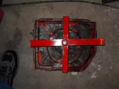

I fond this pic on forabodiesonle.
On my lift the jack is closer to the front of the trans.

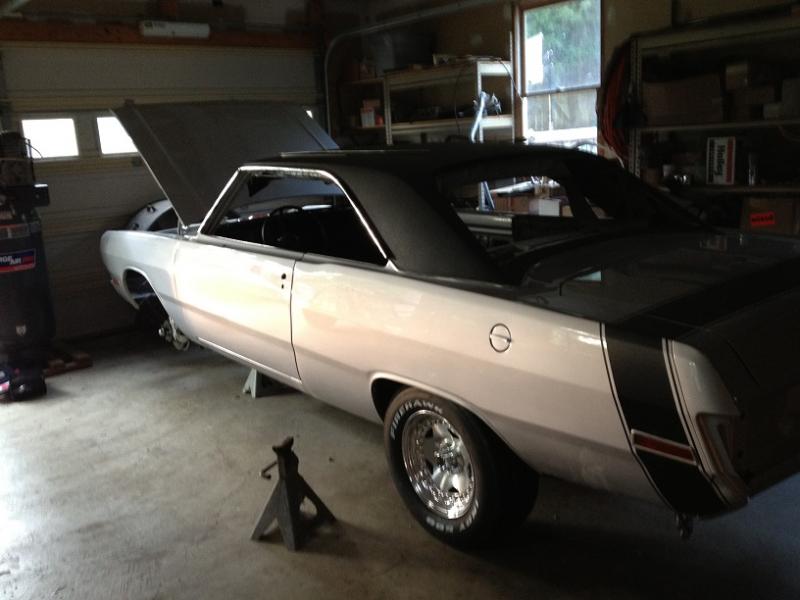

The second pic is of my dart that I am trying to finish.

Thanks Willitay, a buddy convinced me that my original idea would be too rigid for getting the transmission lined up. I like the idea from A-bodies but like you, I would probably place the pipe a little closer to the front.
