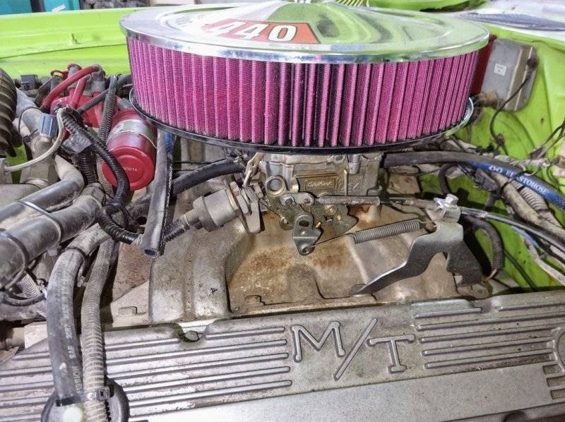

From what I can see it has no kickdown cable. So it most likely is a manual valvebody. If it is supposed to have a kickdown cable and does not it will shift quick, and it is really hard on the clutches no line rise. If the governor is sticking when you back off the throttle when it won't shift the engine will drop to idle. If it is a problem with a shift valve sticking in the valvebody usually it will pull the engine down when it won't shift, and you let off the gas, called engine braking. Best way is to hook up a pressure gauge, Chrysler did a good job of giving pressure test points.

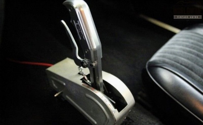

You might want to read up on that shifter as to how it needs to be operated.
Will a overly long cable cause this issue? The cable on her is way too long
I doubt it. What exact shifter do you have? Picture? Most of these shifters do not shift like a normal stock shifter.
It's a B&M pro stick shifter , the cable is way to long , its routed around the transmission once and then to the shift lever , I can manually shift the lever to all gears by hand

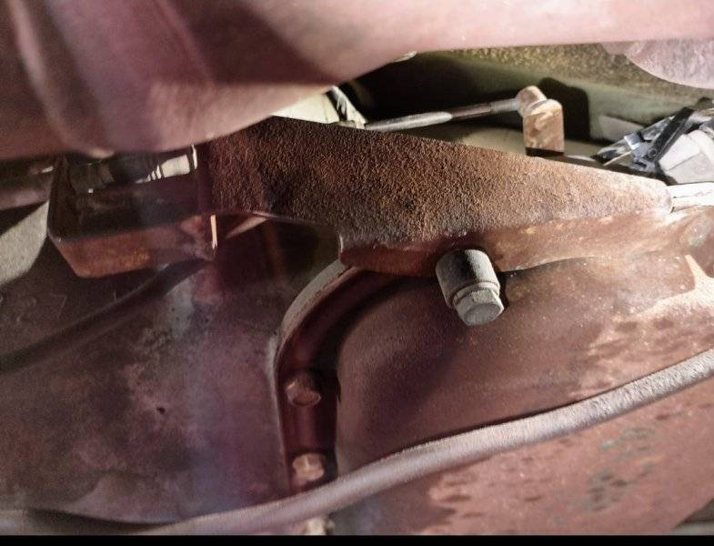

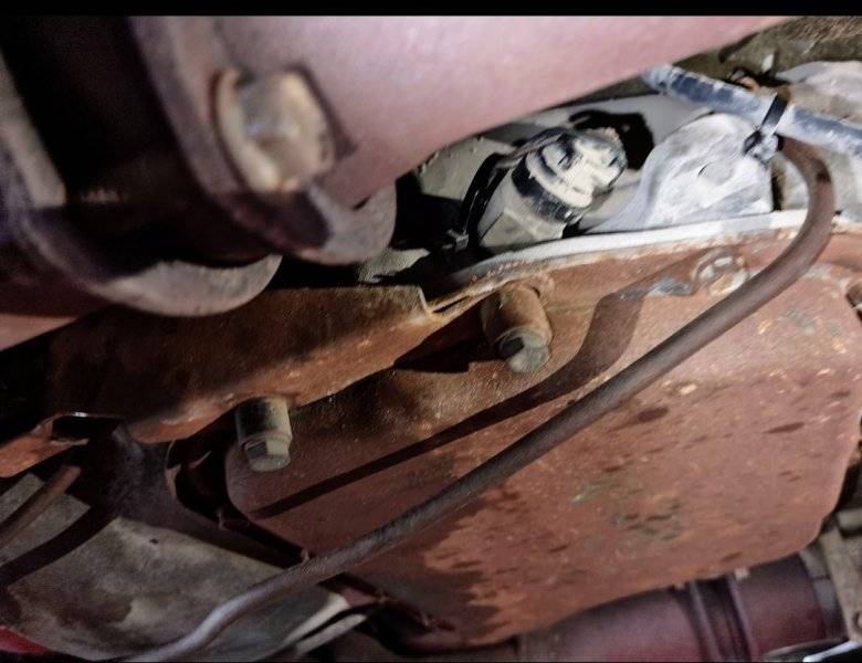

With the car off, get under it and have someone operate the shifter through all the gears. Does the trans lever move as it should?

Did you look at his pictures. There is no kick down with a manual valve body.
