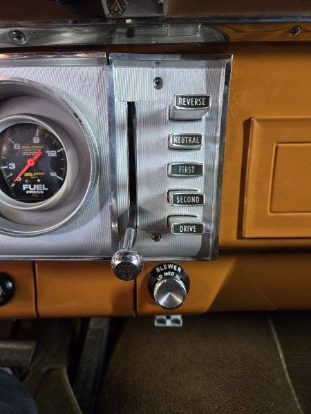

correct dv, its RMVB. D is 1st on mine, 2 is 2nd, 1 is 3rd... I need to find or make a custom indicator. Im in tune with it, but confusing for the uninitiated.
I would agree with the 2nd gear burnout in my case, when I let off in 2nd and 3rd, the engine brakes, for lack of a better term. it does not do that in 1st.
There used to be someone who made the reverse pattern insert. This is where it gets tricky. Do a push button.
