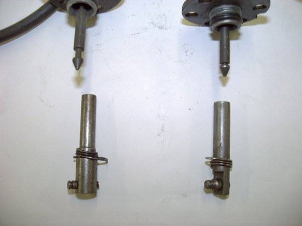

I don't think the '65 valve body will work with push buttons. pretty sure you can put a '64 valve body in a '65 trans and use push buttons.
I run a 65 valve body in my 64. Here are the 2 different types.
Doug
Valve bodies are different between 65 and 64. Think more than just the cable fitting.

I have run a 65 valve body's with my 62, 63, and 64 push button shifters. I've never drilled any of my yokes. Been running 65 transmissions in my race cars since 1992. Never an issue,
