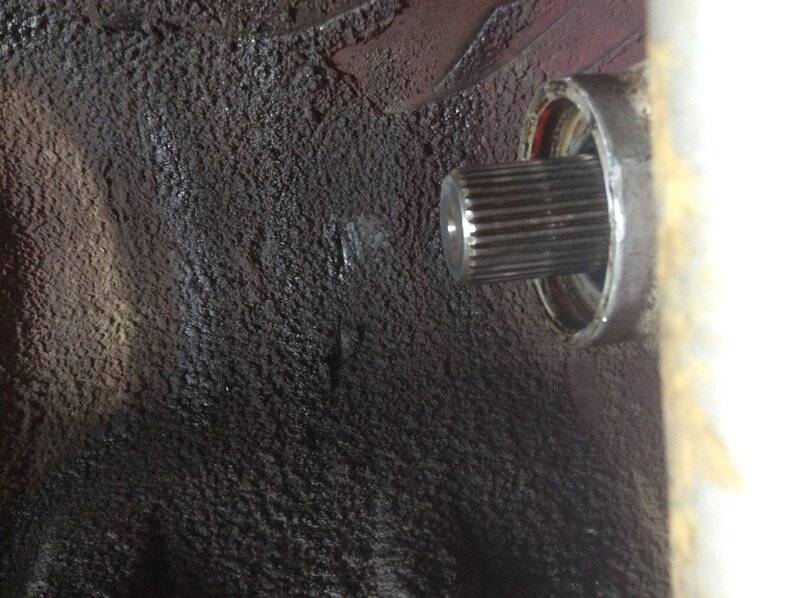

Is it a common problem that the rear seal leaks? Or do i have the wrong yoke?

I would say seal leaks are not uncommon. Especially if the bushing or yoke have some wear and play it can wear out a seal quicker. And a pitted yoke surface will too. Pretty easy to replace the seal but I would check that the bushing and yoke are still tight and free of play.
When you took that picture was the car on a lift so the rear could hang or on the ground ?
Reason I ask is that yoke looks a little to far out from the trans. but if rear is hanging you are probably good
Do you have a different yoke , driveshaft , trans. than original ?
As AR67GTX stated above it could be any of those things mentioned.
There is a play if i push the yoke up and down, does that tell me of a bad bushing then?
Yeah it is on a lift, hmm not what i know about, i think it is all original

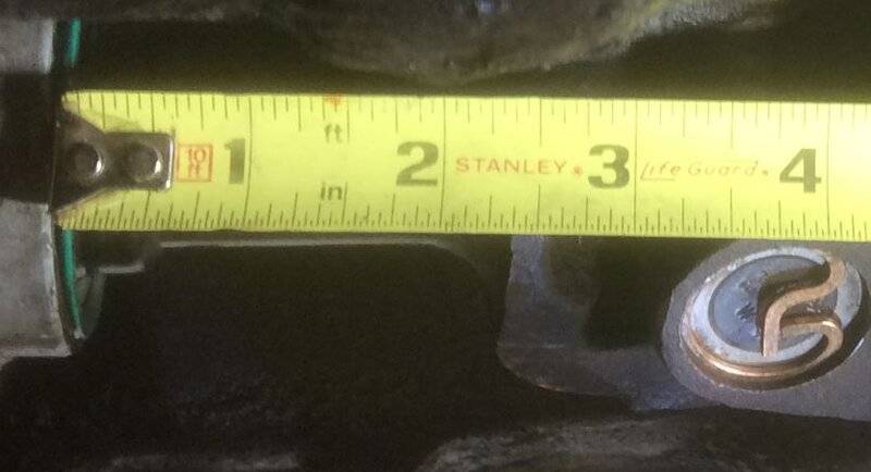

With weigh on the wheels should be close to this. The end of tailshousing on left, blue is the metal lip of seal. This is to show how far main shaft comes out of tail housing
Generally yes, but you might want to re-check with the weight on the tires and the yoke shoved further in. If still any play it could be the bushing or a worn yoke, or both. As far as play, just about any that is perceivable is probably a sign of wear but as the play increases you can get a vibration and the play can beat out a seal fairly quick.
