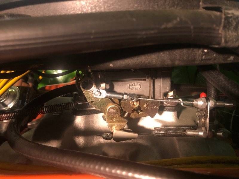

Do you have pic of your current throttle linkage setup? If the linkage is not moving in unison with your throttle, there won't be enough clamping force in the front clutch to prevent slipping under load in 3rd/direct drive. My guess is it's been driven with improper linkage adjustment for some time and the front clutch pack probably needs replacing or total rebuild/inspection. Do you also get any slipping in reverse?

I have a Lokar set up on a 1406 and a Weiand 8008. I'd take a pic but my camera app isn't working. It's in D 95% of the time, very seldom I run through them manually. No slipping in R. It idles at about 800 and feels a little stiff going into R actually but zero slipping. It's seems strong. I csn sit at the RR crossing on a decent hill and it will hold the car with no brake. 2 to 3 is the only issue and it's very slight but very noticeable fluid is fresh and to level hot. Would I possibly have gone too light on the band adjustment or that not necessarily related? Also, it doesn't seem to be getting worse. This is what makes me think its an adjustment issue

I did push the throttle all the way back and there was a small amount to go for the pressure switch to be engaged all the way. I did however add a small amount of pressure and have the 2 to 3 shifts feeling good with no slipping but, my shift points are a little higher than normal and the kickdown doesn't engaged unless I'm doing around 40 or less. Right now it's shifting from 2 to 3 at around 25-30mph. Would the Lokar set up not have the same rate of pull on the trans than the throttle??

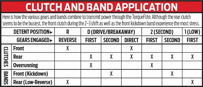

2/3 overlap is common in modified valve bodies. How ever it won't slip. It'll feel very harsh. If the trans slips on the 2/3 at light throttle you have one of the issues listed in post #7. A quick overview of TF operation. You will see the rear clutch is applied in all forward gears. If any forward gears function correctly, It's OK. You will also note the KD band is only applied in 2nd gear. If 2nd functions properly it's OK. The front clutch is applied in 3rd and reverse. However the line pressure in reverse is over double compared to wide open throttle in 3rd. If it slips un 3rd the problem is with that clutch. This clutch can be damaged from hard piston seals, worn reaction shaft supprt rings, worn reaction shaft ring groves, low throttle pressure from improper linkage adjustment, not enough clutches for the power application (3 clutches are borderline for higher power street stuff). Low overall line pressure, water in fluid would likely damage other components. A damaged clutch pack will not repair itself.

Somehow, I totally missed the Lokar cable reference. Based on my experiences with this system, it could be the cause of the problems. The kickdown lever attachment point and the throttle lever attachment point MUST go through the same 1:1 distance of travel to work correctly. There can be a bit of experimentation and drilling of different attachment holes to achieve this critical range of motion. If the car was driven much with the cable misadjusted, the front clutch pack could be damaged.
I appreciate the replies. It seems to like where it's at. I am going to keep an eye on it and see how it goes. I haven't had to light foot it at shifts or any of that. It's been really smooth and consistant. If it's headed for rebuild then I won't really hurt anything. I'm not beating on it all the the time. I was already wondering if the ratio was the same for the throttle and kickdown points. We'll see how things go for a minute
