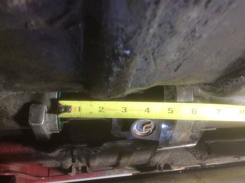

Are you sure the slip yoke is going in deep enough? At ride height the yoke should be out no more than an inch. If the yoke is out it will be loose.

So at ride height suspension loaded take the driveshaft loose and push it in as far as it will go. Mark it and bolt it back up. Measure the difference. My bets you are missing the boat on blaming the bushings. Measure like I said and report back.

Do not be lazy and do not be stupid. Measure and tell us how much the yoke pulls out. You have tried different yokes, bushings and tail housings. You missed it sorry.
Here's a picture of my d shaft. The trans shaft comes an 1' or so out of tailshaft housing. Which means trans shaft is at the 1" line on tape measure. So you have 1" of splines in d shaft left. At 2" mark machined part of yoke ends. Have short seal on trans.

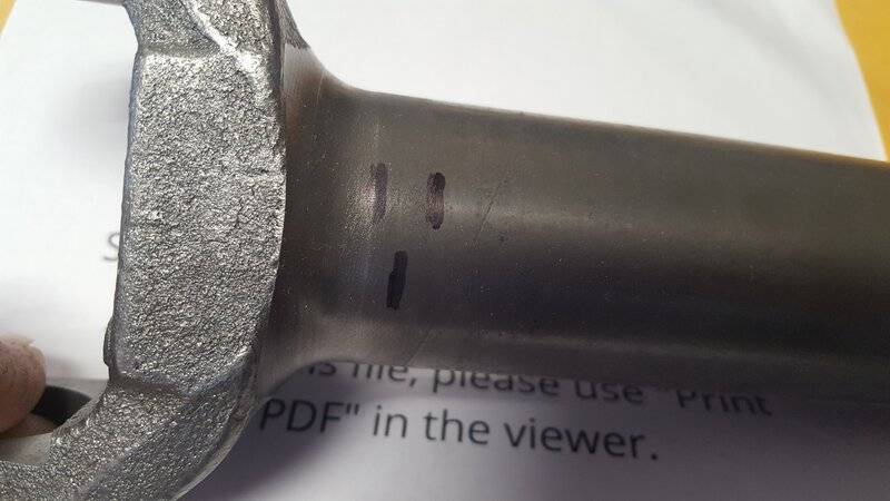

This yoke is from an untouched before me 1970 roadrunner dana car, I have 3 of these driveshafts, all pattern the same within 1/16". Pic shows where the dust seal rode on the yoke, center mark is where the lip of the dust seal rode the most.
