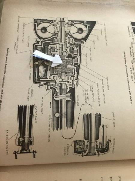

Ok so want change to long output shaft right? Shaft extends into the front planetary assy. See pics arrow indicates end of shaft. If so trans needs to come out

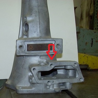

On later 727's that long slot has a OD snap ring. Tge one closest speedo gear.
Speedometer gear was removed. Fran, if you look at tail shaft posted in #7 you can see cover to access snap ring. My tail shaft doesn't have that cover. It is solid. I don't know if park is engaged, hampering the housing from coming off. Park cable was cut, not allowing anyway to pull or push to release park if that is what is needed.
