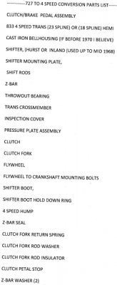

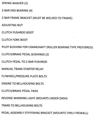

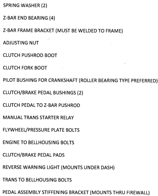

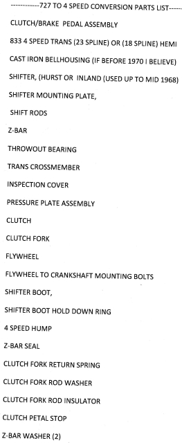

Conversion parts list
Here is my list. Hopefully, I did not forget any parts. Rev might be right on the 10 1/2" clutch, but with my 440 and all the torque, I felt the 11" was the choice for me. Besides, that is the type that was used in early 68's with the big blocks.

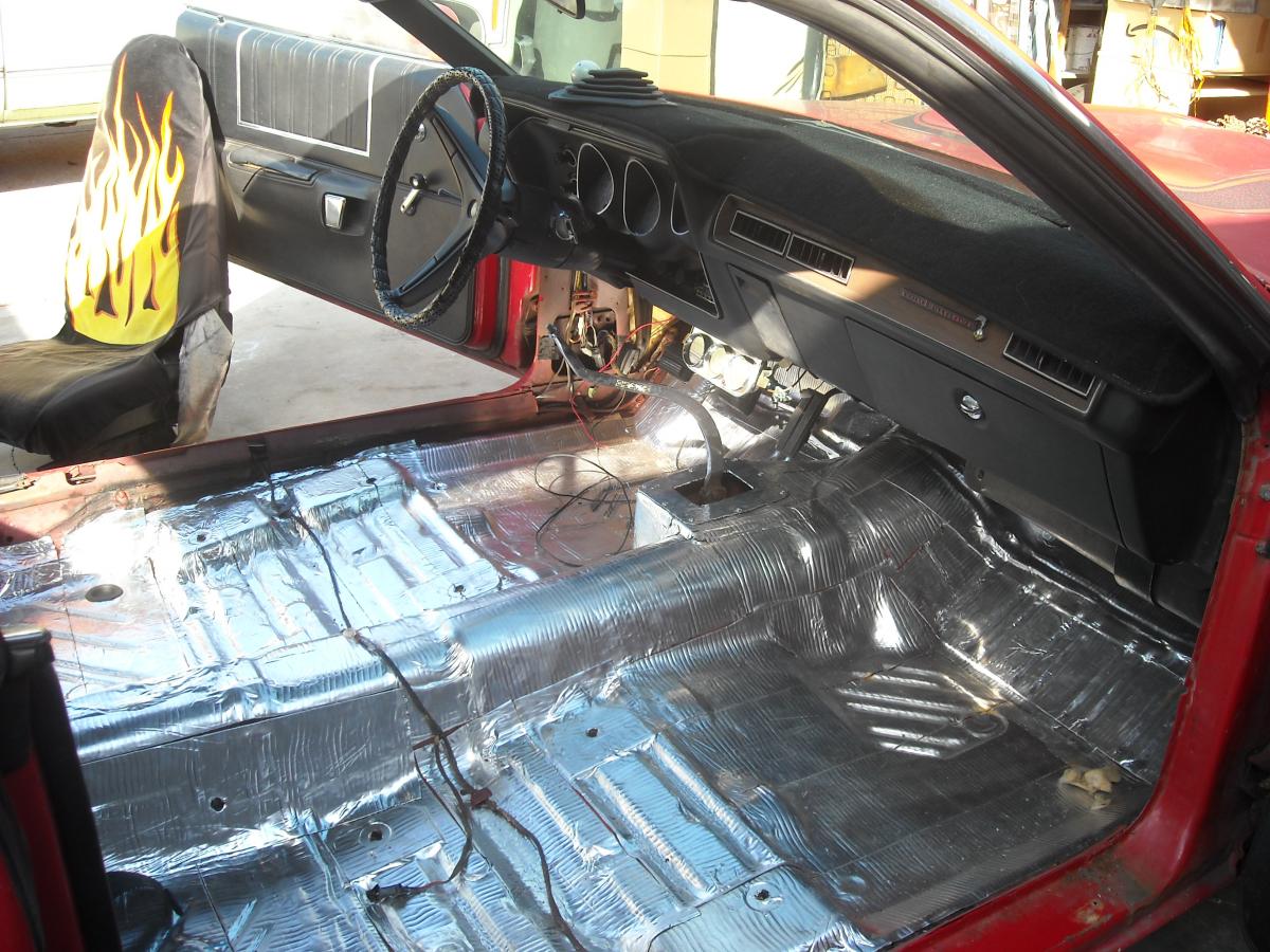

If you use the front mounting pad on your trans, this is where it ends up....
Rev, Yes sir, right where its supposed to be... You have your gauges in the same place as mine, You at some place have heard me say my car is a clone im sure, so you'll know why im asking, you don't know where i could get the roadrunner emblem on the dash at a decent price would you? I put the sound proofing in mine to and havent had it out yet, Does it make a noticeable difference? Its for heat to, but should make a difference in riding also. Please pm me any information if you don't mind, i don't want to interfere with these guys and there work...Thanks to everyone for the help here. Ron
