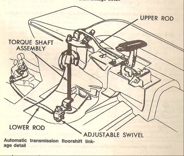

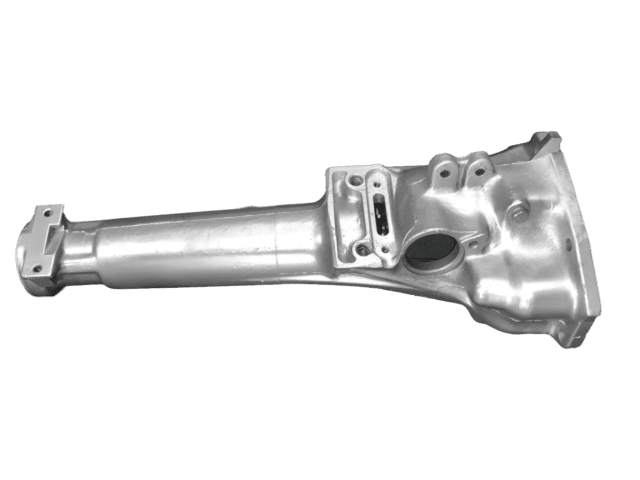

Ive got a 1971 charger with a 727TF. Ot was a column shift bucket seat car. Ive since installed the center console and floor shifter. The shifter has a bracket that comes off the extension housing.
My extension housing has no mounting point for the aforementioned bracket.
Does anyone know an aftermarket bracket that could use extension housing bolts or have tips on fabricating one?
You may have to tap the bolts holes onto the existing trans. Some didn't have the provisions for the floor shift if it wasn't a factory floor shift car.
