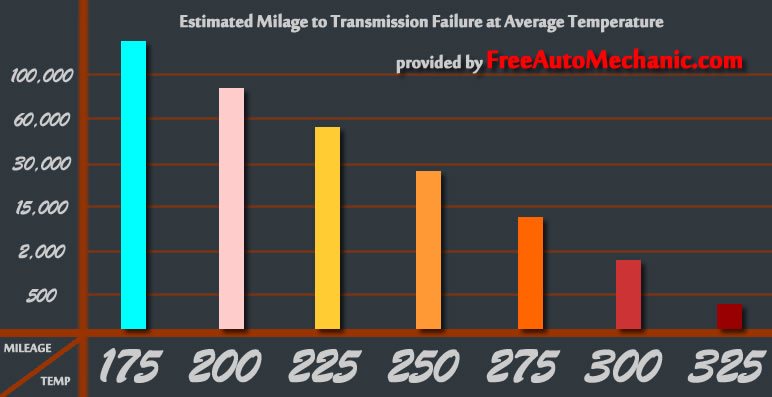

use a trans temp gage if you see 200 or more than yes an outside cooler as said hear from the trans to the rad then the cooler then back to the trans.

tell you what put a trans temp gage and see what temp you are getting then you deside.
