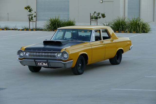

Cool car by the way, got anymore pictures?
