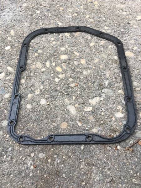

727 pan gasket New style plastic with seal
[2464324AC]
buy this and you will never need another one.

This gasket is for the 904, it is pictured to show what the gasket looks like. Not so much the shape, but texture and the embossed surface.

I used the new O-ring style gasket and a new bolt kit with blue Loctite I bought with my aluminum oil pan. My leak stopped. However, there are some who say only use the O-ring gasket on flat flange pans not stock flange pans or they will not seal. I don't have experience to prove that but there are many other threads here and on the interwebs about it.
The O-ring seal is reusable, too.

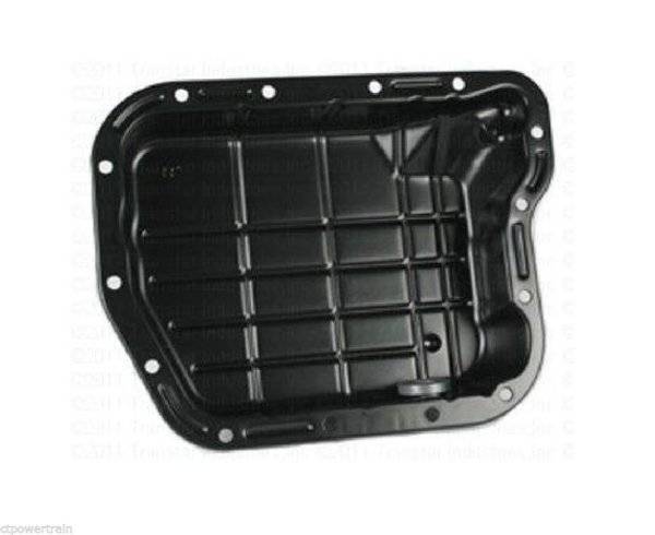

The new gasket works great with the new style 518 pans or pans with no strengthening ribs. Not so well with the older ribbed style pan. Again, the stock gasket will NOT leak if the pan is in good shape and it is not over tightened.

The 518 pan you mention is ribbed.

Not in my 2 old style stock OE pan experience. A ‘79 - 904 & a ‘70 - 727. I just 3 weeks ago made the move to the MP deep 727 trans pan and reused the gasket. No issues.

I've used Mopars transmission pan gasket 2464324AC for years since they came out with it, had my pan off at least 10 times over the years, reused the gasket and it has always reseal the pan with no leaks.
