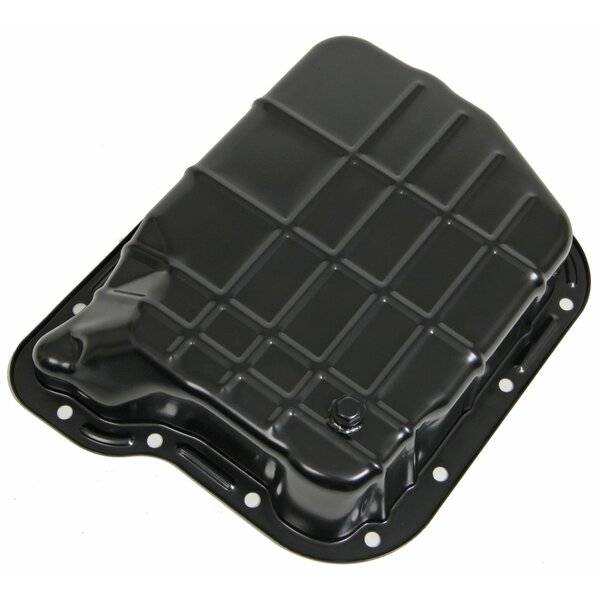

I've been using a DORMAN 265827 pan on my 727s for years now, it allows you to have more fluid to help with cooling, and it has a drain plug too. I added a small magnet to the bottom of the pan and a filter extension, all for under $50.
View attachment 1259162 I've been using a DORMAN 265827 pan on my 727s for years now, it allows you to have more fluid to help with cooling, and it has a drain plug too. I added a small magnet to the bottom of the pan and a filter extension, all for under $50.
Thanks sounds like what I need..
I went with a cheaper chrome pan with a drain off amazon this winter and ended up having to tweak it a bit to get it flat and also had to invest in a better gasket to get it not to leak. IMO these are too thin and flex too much even if you sneak up on the torque. I did manage to get it to work out, but the Dorman or other name brand may be the better way to go and the way I would go if starting over today. I should have come here first, but we all have to learn the hard way sometimes.
Whatever you do don’t buy a chrome pan. Matter of fact chrome nothing when it needs to seal something. Chrome sucks for that.
