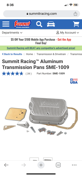

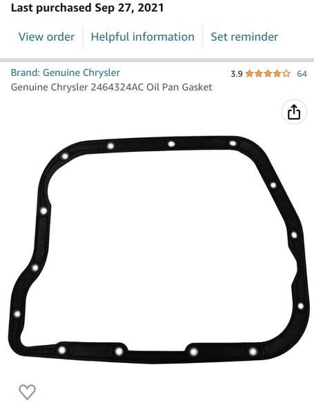

I rebuilt my 727 and used this deep pan from summit along with a genuine Chrysler gasket that has raised lips in the perimeter to stop leaks. It’s can also be reused if needed. That pan is deeper that stock and allows for more fluid, which helps the performance of the transmission. It’s been about two years since and happy to report zero leaks. Transmisión shifts great as well.
Just be prepared for availability and Biden prices.
I would also recommend the lubelocker gasket with the metal core. used one on my a904 when i got a deeper pan and it doesn't leak. As others have said, aluminum pans can be quite pricy so be prepared for that
I had good luck with this also.

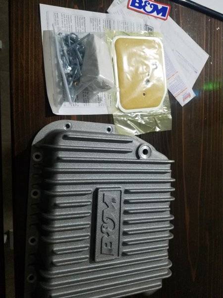

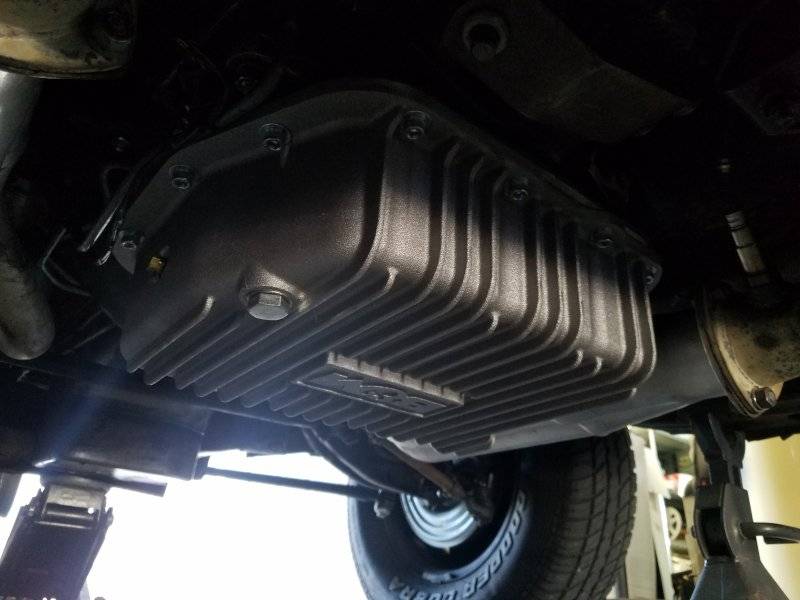

B&M for my 69 GTX. Zero leaks. Looks and functions like a pan should. Made in the USA as well.

I have a B&M pan on my street car. Bought it 20 years ago when 518/46RH stuff wasn't available.

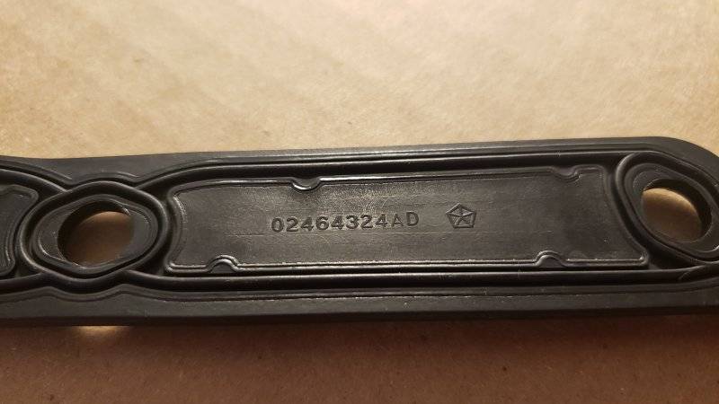

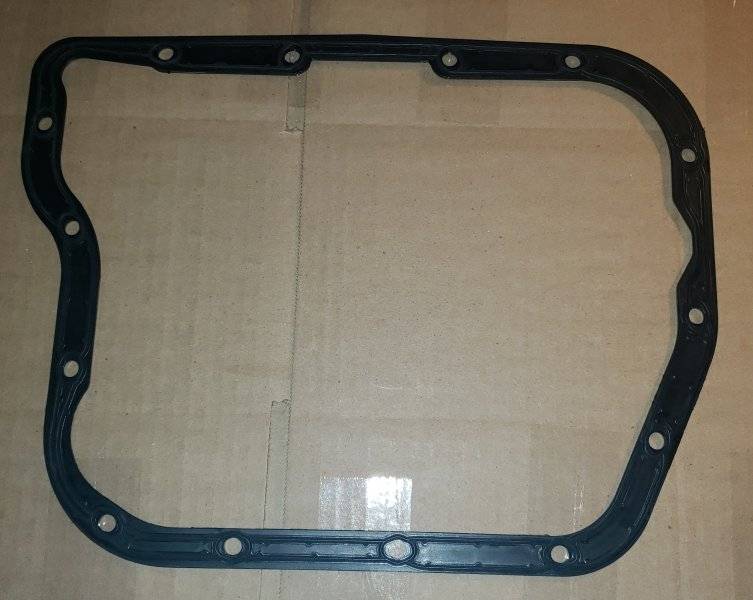

I just purchased and installed a Chrysler product trans pan gasket that looks like it seals great
and has great reviews. Cost me about $32.00 and is re-useable. No sealer!
