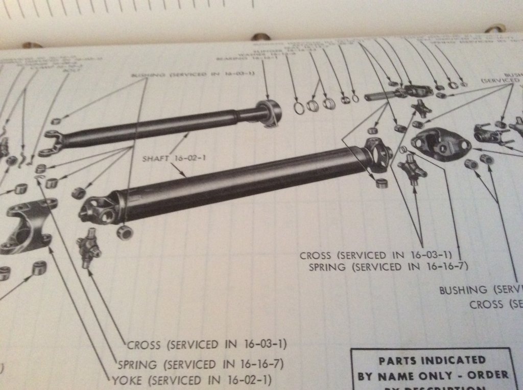

If that trans yoke is bolted solid to trans there was a C/V joint and a center bearing. The drive shaft may have a splined part to take up suspension travel.
T
hese came out of a 66 book. Note the slip joint in upper right corner.
Since a slip yoke will move in and out to take up the suspension travel and mine bolts on, do I need to find a driveshaft with the CV joint and center bearing or can I just switch out the yoke that I have for a slip yoke? If not, can I then use a different input/output shaft from a later 727 transmission when I have the transmission rebuilt that uses a more common slip joint and converter? Thanks
Well you need something to take up suspension travel. Don't know what options you have. Was looking in prop shaft section for something and was looking at picture I posted. When saw your question I could see there could be a problem. I don't have an answer.
