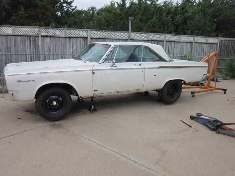

G day all. I have a 65 coronet with original transmission. The shop told me my park cable is not moving....there fore when hooked up , colum shifter wont move. They said the gears were shifting but park cable wont move. Does this sound like a common problem? ANY help would assist greatly!! Tks for your advise.

Shop told me it was locked up and would not move. Myself..I never had a setup like this. I should add...the car has not ran since 1990. Seller says engine has about 20-25000 on a rebuild 318 poly. New tank, fuel lines, fuel pump, carb ,Hei ignition kit and engine runs Great. He parked it because trans went out. He had a good trans to go with it. Thats what the shop was installing when this came up. Tks for your help!

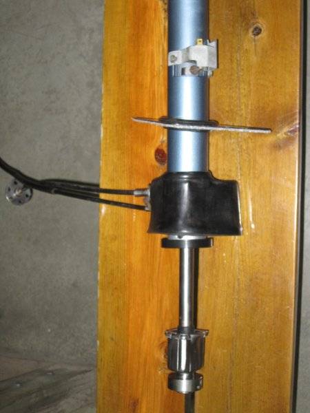

If it is like mine was, it has not been lubed since 1964/5. I recommend pulling the column and cleaning and lubing everything. Be very careful with the rubber boot! A FSM will help. Look in the transmission section.
