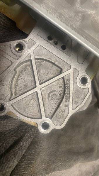

Has anyone ever seen any listing of casting numbers of the 727/904 valve body sections?
I am looking for a spare valve body and the one offered to me has numbers that seem to be '72 year.
Mine is a '69 and as far as i know the '69-'71 are same.
I did some Googling but did not find any listing of years and part numbers like there is for so many Mopar parts.
Any info is highly appreciated!

From what i've found is that mine, 2466886 is orignally for the Hemi's and 440 HP's.
It seems a '68 casting as the 68 is casted in there, though the internals are like a 65-1/2 as per Transgo engineering.
The one offered has number 3410994 and shows a 70 in the casting.
So it's quite confusing so far.

As per the Chrysler bible it should be 2892 355 for the upper section and 2466 886 for the bottom section for a '69 Coronet with the 440 HP engine.
Since mine is 2892 348 for the upper body, i can only assume this is a little earlier version.
Since the '68 parts catalog shows the same and lower numbers for the part, also '67 parts checked but are even lower in numbering.
The bottom section 2466 886 was used over a longer time and is a more "common" part number.
The unit the shop here offered me as a replacement valve body has the "3410" numbers, which are seen in the '72 parts catalogs and i am not so sure this unit is suitable for mine.
As i've seen the valve body does not have the PTKD attachment bolted on, but these years likely could have the lock-up modification.
