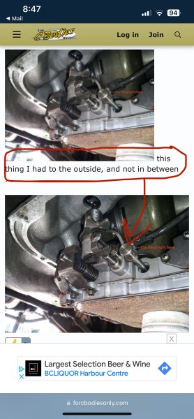

Looks like I found the issue. This little lever needs to get back in between this valve rod (I don’t know what else to call it). Here’s photos of what it should look like vs what mine looks like.
Does anyone have a suggestion on how to get it back in there while touching as little as possible? (To not create another issue through disassembly)
That's what I was referring to regarding confirming if the arm is properly engaging the manual valve. You may need to drop the valve body in order to adjust the height of the detent plate to get the arm to seat between the two stops on the manual valve (if the arm interferes with the outer stop). Check to make sure the detent ball and spring on the rooster comb are properly seated in the bore when doing this.
I'm assuming you removed the E clip to change the throttle lever seal. When this was done the kickdown shaft dropped and the rooster comb moved up. Most likely the detent ball and spring popped out when the rooster comb moved upward. Then the arm was no longer inserted in the manual valve groove. The manual valve selects the fluid passage to send presssure to various clutch packs and bands to create a flow path thru the planetary gear sets to create each gear. For this repair the valve body needs to come out. How did you install the rooster comb detent ball and spring when you changed the seal? Or didn't you? If not it's just setting on top of the valve body. Tell me exactly how you made the repair.

Thanks both! This makes a lot more sense then why I have no gears, and no park with that valve stuck in one place and the arm unable to go far enough over to engage park.
What’s bizarre is I feel like the detent ball never came out (somehow). When manually shifting at the tranny with the shift lever (by hand), I can feel the notches in the rooster click through, one by one.
When I changed the seal, the trans was out on my shop floor. I pull the kickdown and shift levers off, then popped the e-clip out, removed the washer, hooked and pulled the seal out, then tapped a new one in with a socket. I never touched any of it from the valve body side. When putting it all back together from the outside, I couldn’t slide one of the levers down the shaft far enough, nor could I see the notch for the e-clip, which is the only moment when I realized that the shaft could move vertically (live and learn, haha). At that point, I pulled it up to where it needed to be, and got it all back together.
Now in hindsight knowing how all this goes together, I am really puzzled as to how this all happened and that ball potentially stayed in. Sounds like in either case though, pulling the valve body is going to be the safest bet to make sure everything else is good!

Happy to report we now have gears and parking back! Thats all it was; lever needed to hook into the valve again.
The ball on the rooster was still in place when I pulled the valve body, too! Surprisingly
