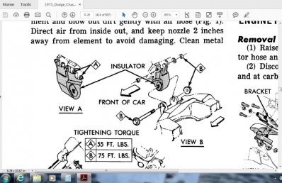

All of my "before" pics are too far away and dirty to tell how the mount goes on the boss.
(yes I did a search)
This is what I think on the pas side.
Am I correct?
How about the bolt orientation?
Heads to the front?
Bottom only gets one bolt, and it's in the front hole with head to front?
According to a 73 manual, the mount brackets go against the rear side of the block ears as you have in the picture. The bolts go from the inside out, meaning the nuts attach to the outside of both sides. The long bolt for the crossmember goes from the front, and nut in the rear.
