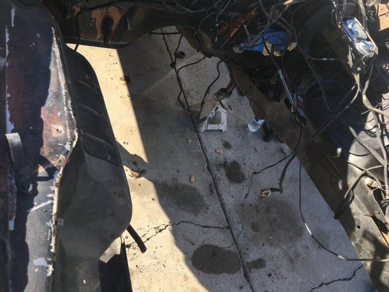

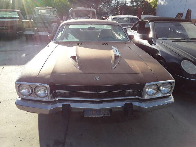

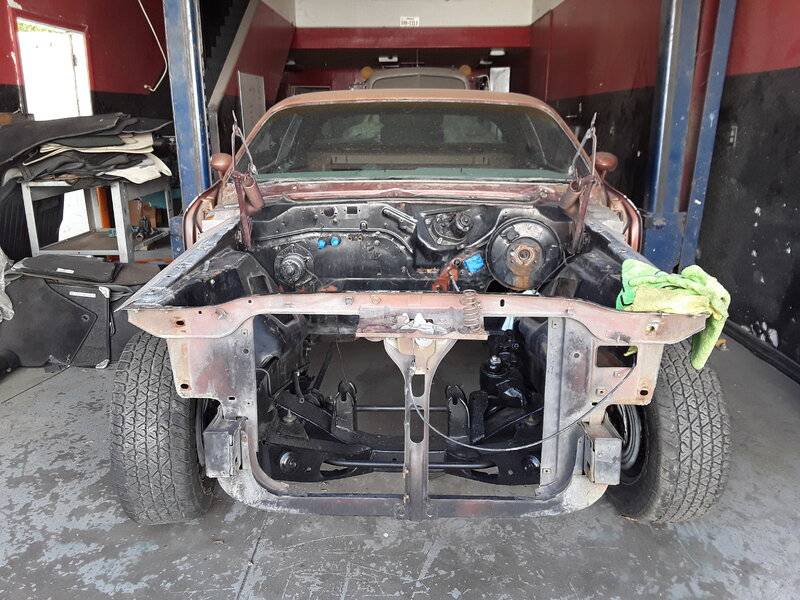

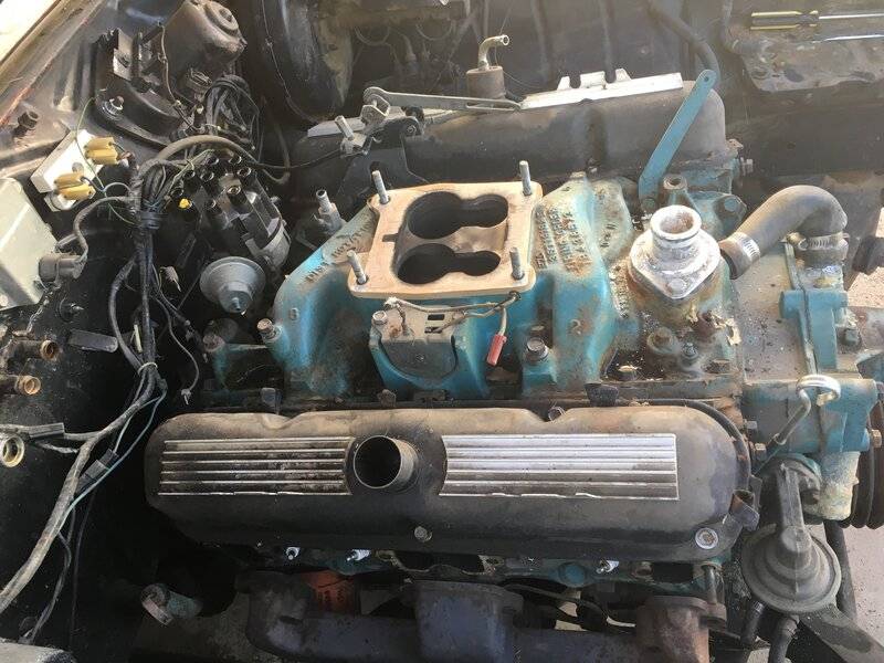

I parked my car away in the garage in 1990. Moved it from Los Angeles to Orange County to the Bay area landing in Colorado in 2012. Shipped it to a friend's shop in Mesa AZ. Started taking her apart in Oct. of 2018. I'll work through the project till current.
Here's my starting point.

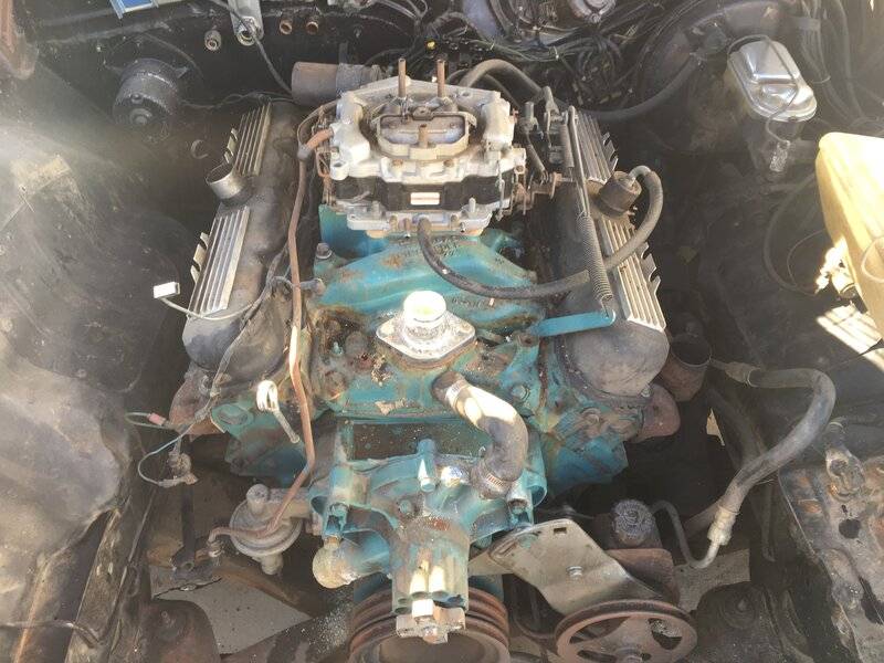

Taking the engine apart, ready for removal

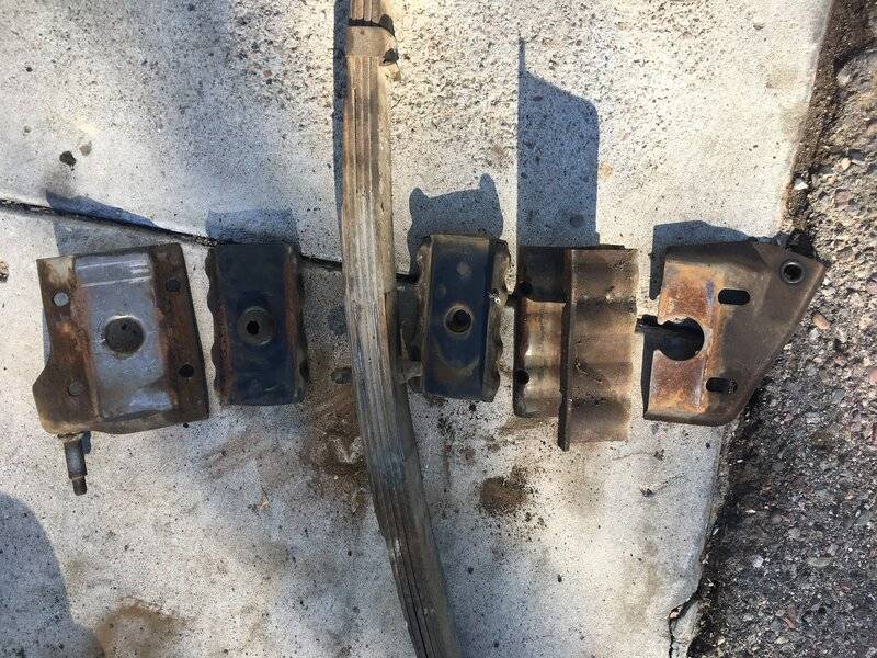

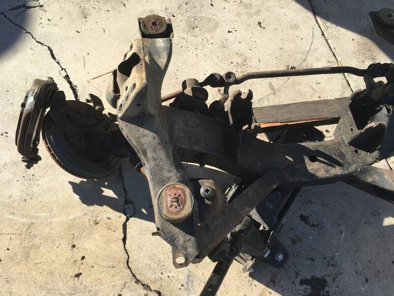

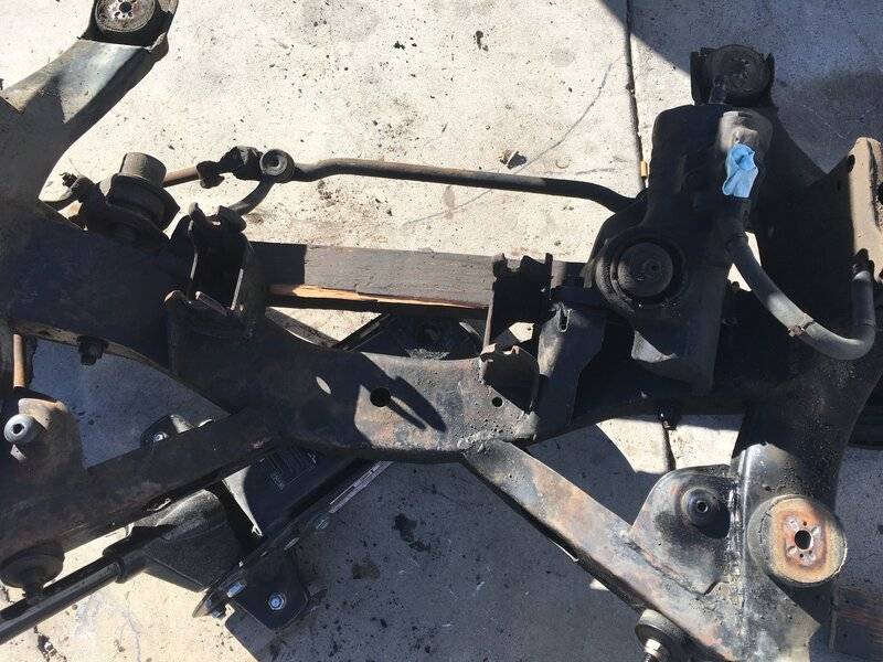

On to the suspension
Awesome. Spill the beans on specs. I see it has PS, PB, and AC. Stick or auto? Bench, buckets, tach?? Inquiring minds want to know.
It is a 340 auto originally a column shift bucket seat with the buddy seat in the middle. You will see I change to a console back in the 80’s Has a Ralley dash with a clock. But changed it to a tach. Came with a tuff steering wheel. Has a 3.23 sure grip. I will be posting more pics until I bring everyone to where I am at today. Since it is 90% original I would have preferred to keep it that way but the original trans is long gone and things like alternator and p/s pump have been replaced over the years Put on 2.02 heads back when I built the motor the first time. More to follow

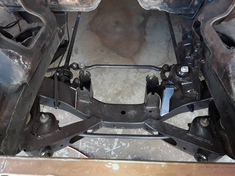

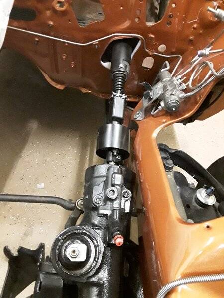

Here are before and after pics of the suspension rebuild. All new wear parts, ball joints, idler and pitman arms...you get the idea. Had the rear end gone through then reinstalled new bushings and insulators. It is not concours but it turned out nice

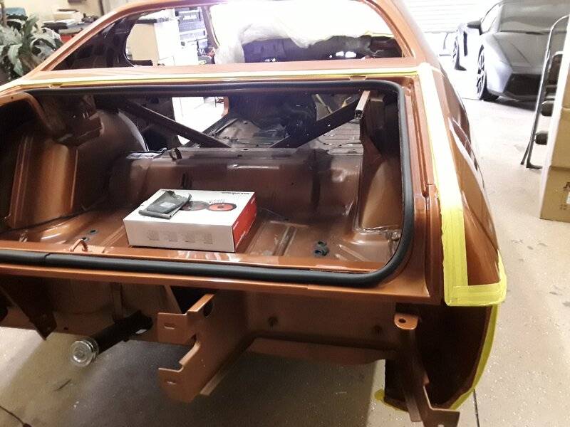

On to the body work
Fresh bushings, brakes and joints will make a huge difference. Nice!
The bodywork

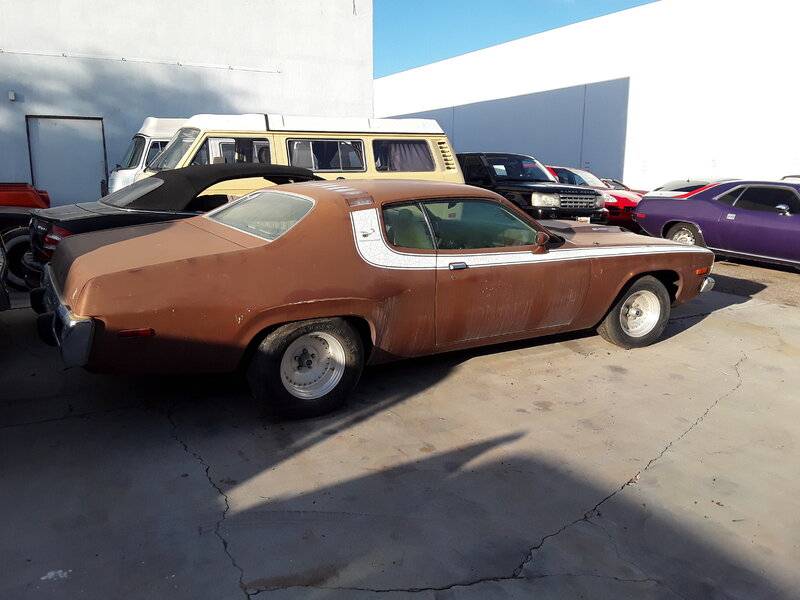

As I am dismantling the car if found 10 lbs of sand, probably from my youth living in Palm Springs. Also found the car had be painted a different color, maybe the first owner had the dealer paint it or something. Seemed odd since I have owned it since 1977.
Was able to repair the valances front and rear but had to replace header, cant see it in the pic but the crease in the inside corner of the pass headlight was beyond my abilities so I found a straight 50 dollar replacement.

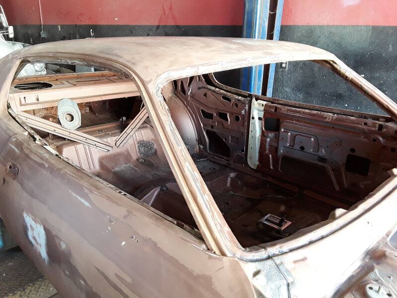

I found it easier to keep the doors on for prep, also put the fenders back on for prep as well.
Sure had a lot of small dings and small dents. But lots of sanding and elbow grease and we were getting close to primer. I did weld the metal fatigue cracks on both doors just below the A pillars. See half circle in the pic.
Have two of these 340 '73 RR (one auto one 4 speed) that are/will be restored. Have noticed that there is not a lot of flat sheet metal on them. Everything is a curve of some kind (little harder to work on IMO). Have not had to deal with the metal fatigue that you and several others have mentioned. Looks like you have this project well in hand. Best of luck with the rest!
Nice work so far. My Road Runner was "Tahitian Gold Metallic" (I think paint code JY9). Yours looks close. Is it a JY9 or other color? (Looks like it might be K6 or T8?)
Either way, cool color - too many, including mine, have been changed. I'd love to put mine back one day in the future.

Thanks, it is K6 but based on what I found as I prepped for paint I think the whole car was painted either by the dealer when it was sold or by the first owner. I figured out that I am the 3rd and I am still friends with the second and he did not paint it.
Are you getting it ready for media blasting?
Actually farther along, I have already painted the car. I thought about media blasting or taking down to bare metal but just decided not to do it. The car was solid as it was a California desert car and I have keep it in a garage most of the 40 plus years I have owned it. It did have filler in a few spots, I am still at a loss as to when that was done I hope I do not regret leaving it.
