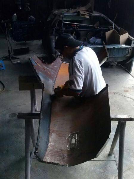

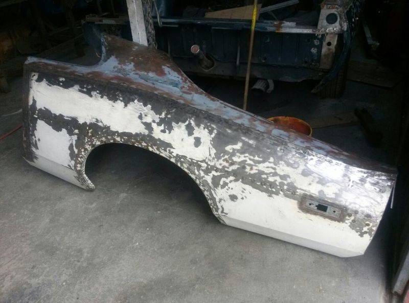

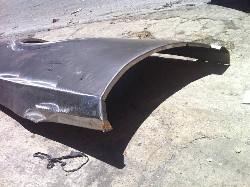

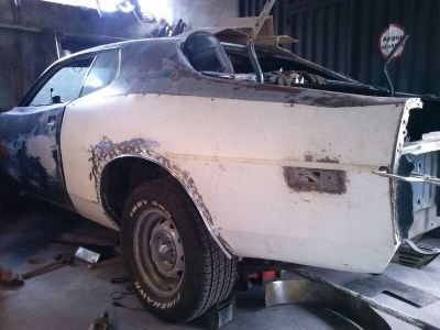

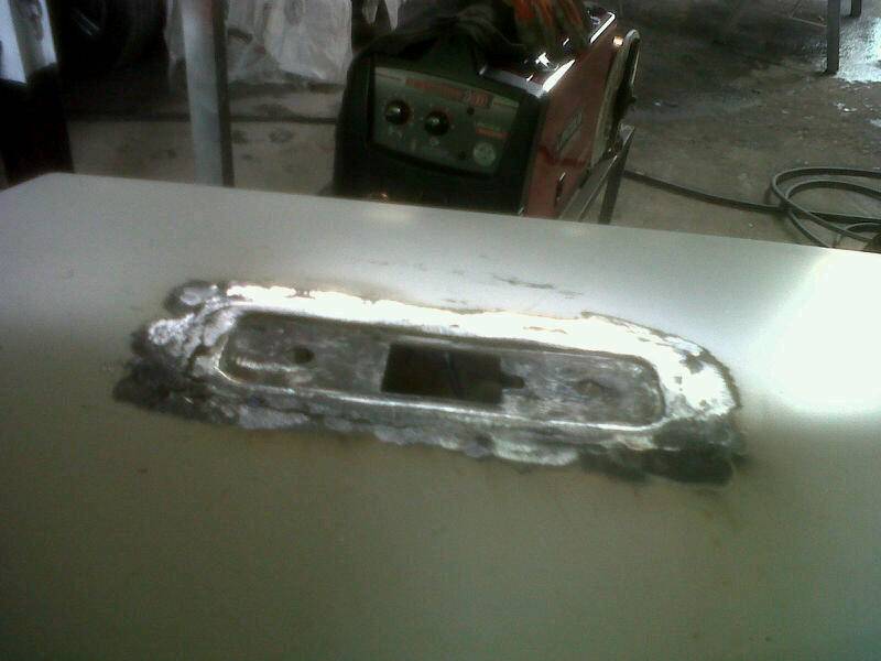

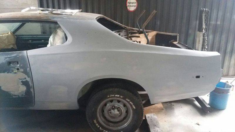

we ended making the skins by ourself
we cut the recessed area for side marker from original and welded on the skin
even the skin was made from above the upper line I dedided to keep the factory upper body line.... fit test ( including molding )
removed C pillar section and worked out of the car
and quarter panel back to the car already primered
