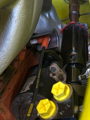

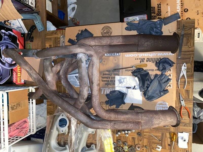

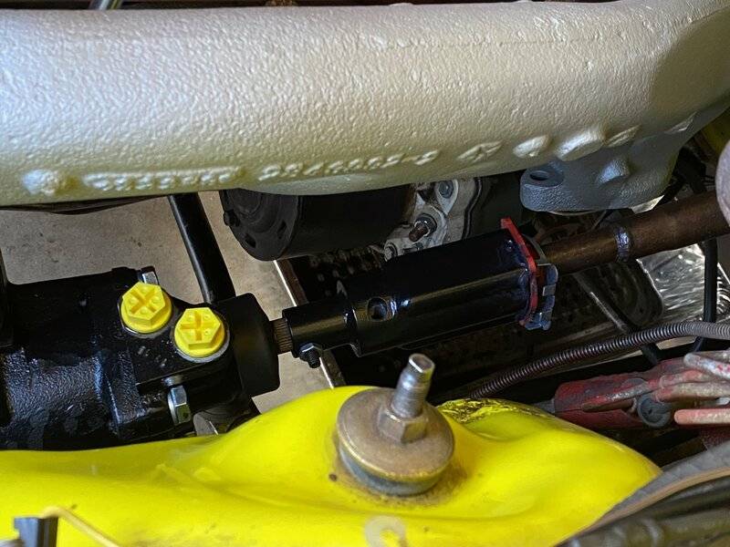

I have installed the Borgeson steering box and Bergman coupler on my car, a 71 Charger, just recently. The car had headers on it before the install, which did not clear the Borgeson box. I am installing a pair of factory HP manifolds instead. My driver side manifold clears the coupler and the steering shaft.
I cannot locate your manifold part #2861861 on the net. Is this a non-HP manifold? Sounds like it might be for a 2-bbl non-high performance engine. My driver manifold is part #2843992, passenger side is #2806900. My particular manifolds were manufactured in 1968. You should be able to use any HP big block manifolds that were made from 1968 to 1972, maybe even later. You don't want the log style that hangs down, you want the HP style that goes upwards.
See my photos. Had my manifolds sandblasted and ceramic coated using Cerakote Titanium. Long story, but they were originally coated Blue Titanium, and I had to have them redone. They didn't re-coat the insides so that is why they are still blue inside, which will turn black anyway from carbon once they get used.
I also included a photo of the old rusty headers that wouldn't clear the Borgeson box. The manifolds now look much nicer than the old headers..

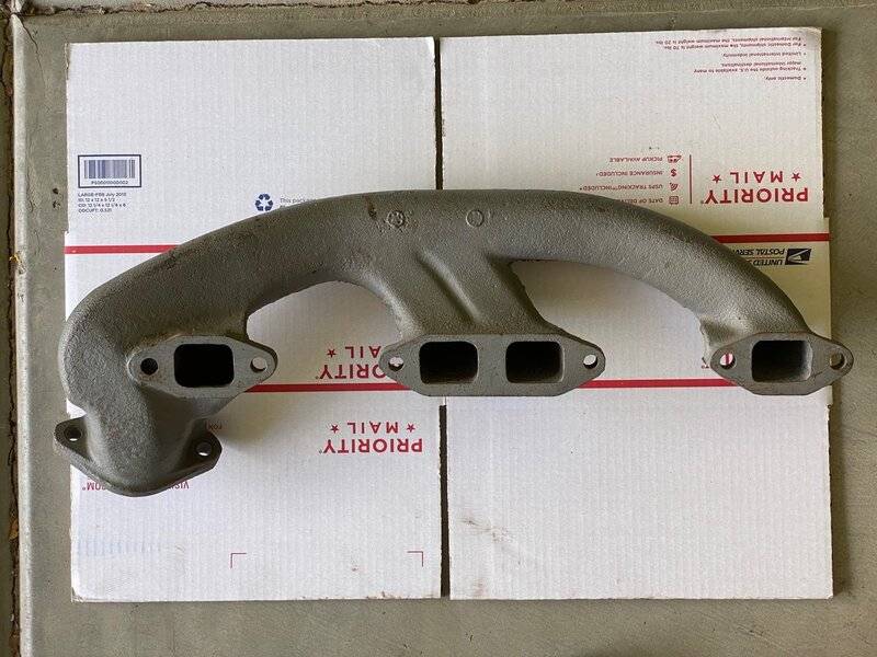

Hi, many thanks for your thoughts.
You are right, I incorrectly read the casting number, sorry. On my particular piece it is quite hard to distinguish between 5, 6, 8 and 9 with the character set they used. I verified that #2951861-4 should be correct. This one here in the photo looks like mine. It has the output flange between cylinders #5 and #7 while yours seem to have it even behind #7
Your manifolds look great. It seems that my vague idea about the manifold being incorrect is true.

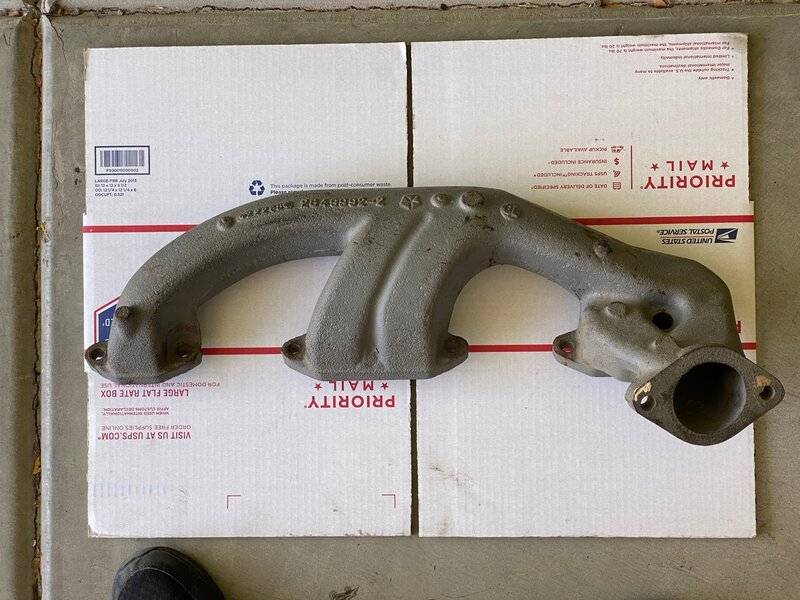

Yes, the output flange on the driver side HP manifold is aft of plug 7.
I need head pipes (down pipes) for my car. That is another problem to solve before I can get it running. I looked at the Big Block Mopar set offered by Magnaflow, but read too many reviews about them NOT properly matching the clocking of these HP manifolds. The different HP manifolds have different clockings too.
I bought manifold flanges from Mancini Racing (i think it was) and will probably be having a muffler shop custom fabricate head pipes, welding the flanges I bought onto the pipes at the required clocking (whatever that ends up being). I'm using the existing 2.5 inch exhaust on the car, mid pipes all the way back to the machine gun tips. I'm sure the custom head pipes made at a muffler shop will have to be pressure bent. The existing pipes are all pressure bent, so doesn't seem like using mandrel bent head pipes would be that beneficial with pressure bent mid and tail pipes.

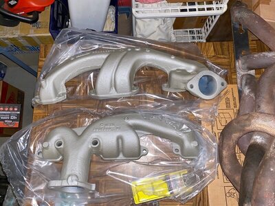

I've attached photos of my driver side manifold before it was sandblasted and ceramic coated. This manifold will not interfere with your coupler or gearbox.

thanks! You pointed me in the right direction with the hint about the exhaust manifolds.
I got hold of some used HP manifolds, interestingly with the same casting numbers like yours.
Will install the Borgeson steering box and the Bergman Mopar coupler. And then weld up some exhaust downpipe to get her running for the summer asap.
