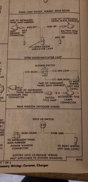

Picked up all parts for a rear window defogger. Wiring was clipped before the connector at both ends. Does anyone have the wiring diagram for this or know where I can get one?
I will take a pic of the wiring diagram and attach it. This is for the switch under the dash.
That is the only diagram in the service manual.
After the "body wiring" plug, is just a two wires harness between kick panel and rear deffog, black and white wires one for each speed. If you hook them up reversed to the blower motor will get just the wrong speed selected... switch them out at blower plug and will be done.
