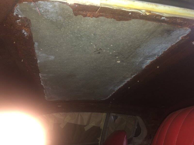

Hi, new member here.
I am restoring a 73 charger and it had a sunroof.. previous owner blanked it out and painted over it.
I am hoping to restore it to as close to original as I can. Anyone help with sourcing one, or finding an aftermarket that is close to original. Perhaps off another vehicle. Your help and advice is appreciated.

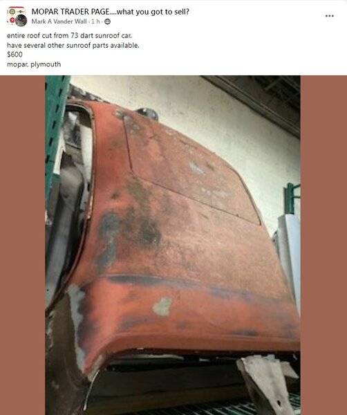

If A body sunroof is the same ( which could be very well... I don't think the small production of Sunroof cars would require a diff piece for every body, except for the roof skin )... there is one on Fb Right now
