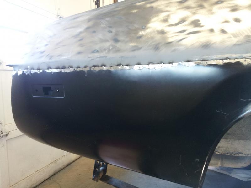

I bought a set of rear 1/4 patch panels from Year One earlier this year. They are just the piece behind the rear tire to just above the marker light and go into the wheel opening on the back side. They came as a pair for about $320 with 25% discount they often offer. Made by AMD and discontinued making them . replacement quarter RR.jpg
