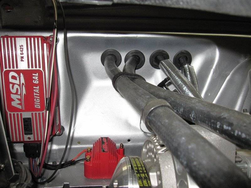

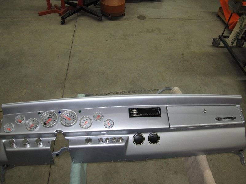

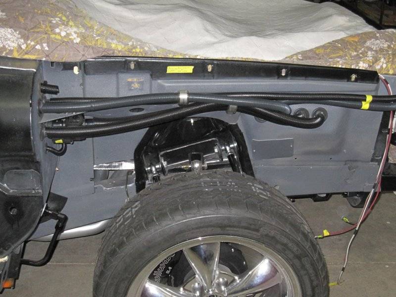

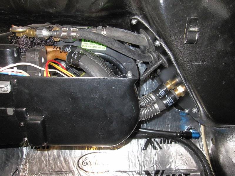

I used a VA kit in my 65 Belvedere. Not shown are the 4 under dash VA defroster outlets I chose for lap cooling. I split the evaporator outlets with wyes to duct air to a pair of outlets on each side of the car. I also had to use the 3 duct model because my trans tunnel was too large to accommodate the 4 duct outlet model.
