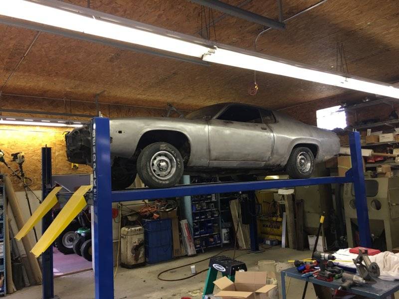

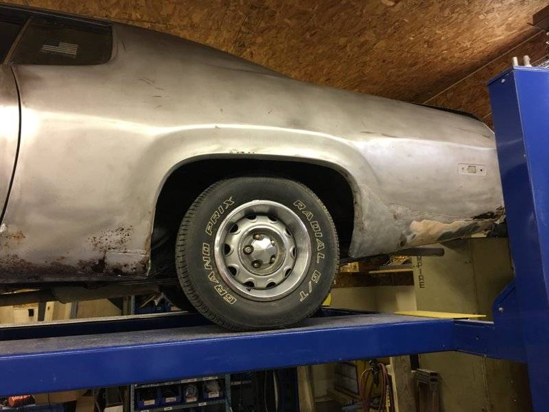

I am at the beginning of a body restoration on a 73 RR and am looking for help on 1/4 body panels and where to find them.
I can find the rear 1/4 patch panels from Restoration Performance,
My question is there anywhere I can find or interchange the front 1/4 panel and the wheel opening ( see photos )
I am working on the car for a buddy and not that familiar with the Mopar cars so assume I know nothing about this car,
Any help describing the differences between the 72 vs 73 would be most welcome, It almost appears to me to be a roof line change but the lower half ( which is what I want ) is the same ? trying to see if I get some 72 stuff it can be modified to work
I don't want to order panels that will not fit

72 and 73 are 2 different animals
The Roof and some of the inner structure
Is the same and after that not much is
Compatible.
You need to use patch panels or donor metal from another 73 or 74 car or fabricate what you need

71/72 and 73/74 are completely different with respect to the quarter panel.
From the pics it looks like the hard part (wheel arch) is still OK.
its not unfortunately, passenger side is worse on arch , I can handle most metal work ok but the arch looks like a bear ,

Look at a repro fender for a 72-80 Dodge truck.
YES, TRUCK!
The wheel arch is almost exactly the same at the rear arch on a 73/74 Satellite!
...and they are reasonably cheap from truck parts suppliers.

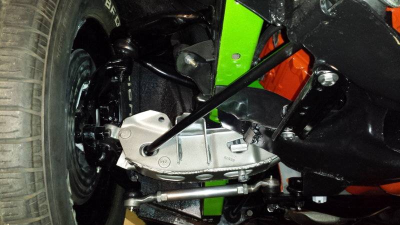

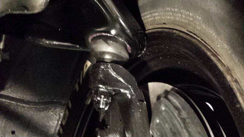

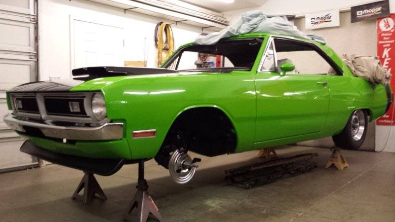

The ones on my Dart are from a 73 B and hit my 15x7 Ralley wheels big time. Had to use wheel spacers just so I could roll it. Does't matter where I set the camber they still rub. The UCA's are point upwards, not level. I measured them several times and compared them to the several other cars I have and these are definitely 3/4" taller. I've been assembling these front suspensions for about 40 years now, well over a 100 of them, but have never used the taller spindles on anything but the 73-9 B's.
If you still have the ones that you pulled measure them against the ones on your 70 Charger and see what you come up with.

My wheels are stock with 4.5" BS. Also the work in picture is clearly a hack job, right?
Hack job? Of course not. I don't like Sublime but not enough to criticize your work!
Oddly, the left picture seems fine but the right looks as if the suspension is at droop..... and the distance between the UCA edge and the knuckle looks wide as if the ball joint were really long. Maybe an illusion?
Illusion I guess. Normal ol' ball joint but a urethane boot. I too don't care for Sub-Lime that is why it is Sassy Grass. Looks a little lite in the pics
